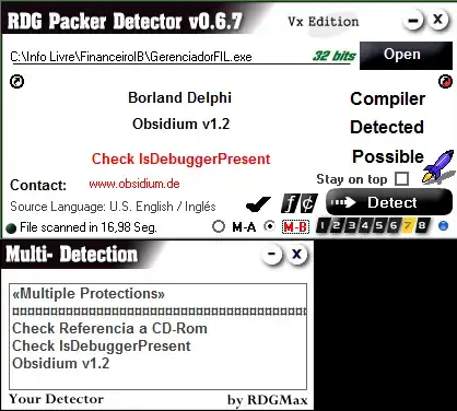

It really appears to be developed in Delphi, with CFF I confirmed it. Also, there is no section that points for an packer looking at CFF information and EXE Information and RDG also say it's clean. However, RDG found IsDebuggerPresent and pointed for an protection software as you may see. However, I'm not sure if it's a false-positive.

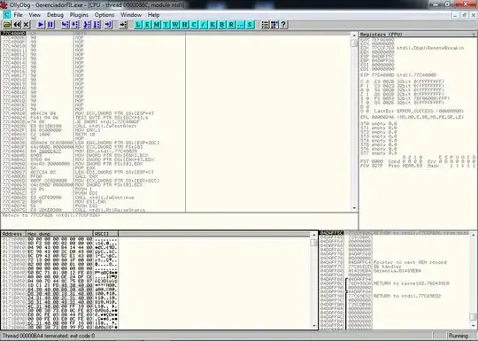

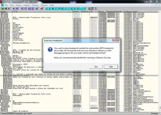

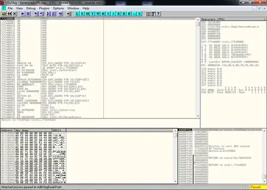

Below is a screenshot once I attach to the application running:
When I press "run" at OllyDbg it's what I get:

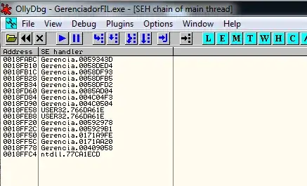

Here is a list of SEH chain:
Here are the "Windows" available, including the one that I would like to disassemble, examine and put a breakpoint:
However it fails to debug, see below, please:
Is it some kind of protection? How to disable this part of code, put breakpoints, etc?

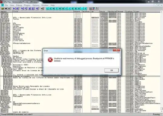

Additionally, I noted that are parts of the application when some texts are not stored as a "TextString", instead I see "char by char" in sequence at OllyDbg creating a few strings (also not very useful to me).

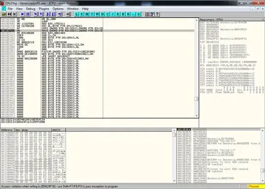

If I define a breakpoint in any of these TextStrings it's what happen - an exception:
Is it a protection? Any idea how to bypass it?
From here the only thing that I'm able to do it pass control to the application and all is over. :(

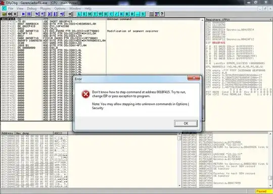

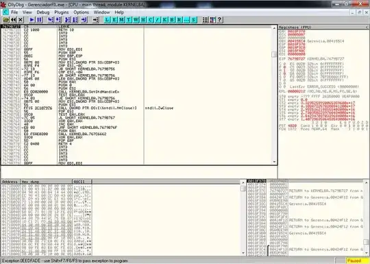

Also, if I refuse to pass control to the application and I continue with F7/F8 I get something like that:
It ends with an instruction not recognized by OllyDbg. Any idea?

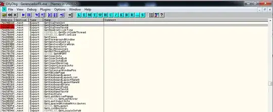

I also tried to set breakpoints in Names from user32.dll such as GetDlgItemTextA and GetDlgItemTextW since I believe they are the APIs used to read my entered serial number. The strange thing is that they are exported and not imported as demonstrated below. Is it normal?
Once I created the breakpoint and stated stepping into I got this exception again and I was forced to pass control to application and game over again. :(

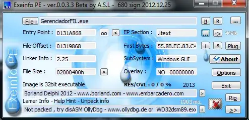

First I updated my PEid database from this link:
https://code.google.com/p/reverse-engineering-scripts/downloads/detail?name=UserDB.TXT
The following screenshot demonstrates PE details:
http://img444.imageshack.us/img444/8295/16pedetails.png
Here are details about PE sections:
Looks a bit strange for a not packed binary, right? But I can't figure out the correct packer.
http://img5.imageshack.us/img5/5764/17pesections.png
Entropy and and Fast Check say "not packed", but EP check points as packed:

RDG Packer Detector pointed that Obsidium protection was present, however I guess it's a false positive. See the unpacker failing to recognize the format:
The unpacker is available here: http://down.52pojie.cn/Tools/Unpackers/
http://img29.imageshack.us/img29/7/20obsidiumunpackingfail.png

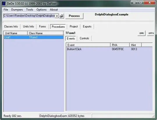

Have a look at R4ndom's Tutorial #17 on working with Delphi binaries and cracking them: http://thelegendofrandom.com/blog/archives/1472
He describes how you can use Resource Hacker (I prefer XN Resource Editor) to find the event handler for the form that calls the dialog you are looking for.
With knowledge of the form you are interested in, download DeDe and load the application into it. After DeDe completes its analysis, click on the "Forms" tab and you will see all event handlers associated with that form (OnClick is likely what you are looking for here). With the name of the event handler, click on "Procedures" and find the event and you will see its address.
From there, load your application in OllyDbg and set a breakpoint on the address of the event handler that you are interested in. This should put you near where the registration dialog is prompting you. The R4ndom tutorial can describe any necessary next steps from there.
