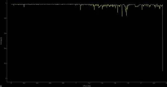

The firmware is compressed, so it is no wonder that up to this point attempting to determine the target CPU of the firmware has been so troublesome.
compressed firmware image
A signature scan reveals a signature associated with LHA compression:

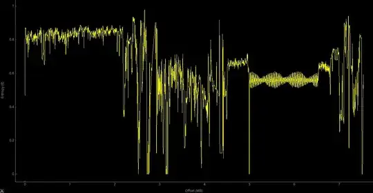

Be aware that some may be false positives. For example, I believe that Broadcom 96345 firmware typically targets MIPS CPUs in routers. Further investigation is required. An entropy scan of appli.bin reveals that it is not compressed or encrypted:
uncompressed
There is quite a bit of string data in this binary, some of it potentially interesting. For example, this bit:

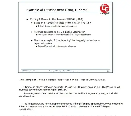

There is quite a bit of technical information contained in this document; for example on page 71:
doc page 71
It may contain information relevant to identifying the CPU, as the SH (SuperH) family of CPUs is discussed (Renesas SH7145, SH7727).
