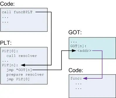

In fact, the behavior you are describing is coming from the usual behavior of the GOT/PLT sections. They are used to dynamically link the program calls to shared libraries functions at runtime.
In fact, a shared library can be loaded at any place in the process memory, there is no way to predict statically where it will pop up. So, the GOT/PLT load the address of each library's function dynamically at runtime and cache it for further use.
The way it works is pretty simple, the PLT (Procedure Linkage Table) is just a bunch of small code gadgets (one for each library's function called in the program, plus one generic code located at the beginning of the PLT section).
And, the GOT (Global Offset Table) is just a table used to store (and cache) the addresses of the library's functions.
At first, the GOT is all set to zero because no function address has been resolved yet. The GOT get filled all along the program is executed and call new functions (some functions may be called only rarely and their address may be only rarely filled in the GOT).
When a library function get called the program counter goes to the PLT (see the figure below) and executes the code specifically written for this function (each of the code gadget has its own offsets to get the proper address from the GOT). But, at first, the GOT contains only zeroes, so you need to initialize it.
To initialize it, you jump at the very beginning of the PLT and find the address of library's function the program want to call. You execute this code and, then, you write the address of the function in the GOT.
PLT/GOT Schema (before)
Once you cached the address of the function, you do not need anymore to recompute the address if you call your function and you jump directly to it (as in the following picture).
PLT/GOT Schema (after)

While the other answer is not wrong, it does not actually cover the real issue: how come that calling a zero address does not lead to a crash?
AFAIK there is no official standard or complete documentation for this, but de facto the first few GOT entries are special/reserved and are used by the dynamic loader/linker (sometimes also called interpreter) for its own purposes:
  • GOT[0] points to the _DYNAMIC symbol of the current module which is the start of the list of tags (Elf32_Dyn entries) with the various information necessary for proper resolution of dynamic symbols. See the ELF specification.
  • GOT[1] is populated at runtime with the pointer to the link_map structure containing the list of all dynamic images present in the process. This list resides in the dynamic linker (ld.so on Linux systems and linker binary on Android).
  • GOT[2] is also filled in by the dynamic linker and points to the resolver function (_dl_runtime_resolve in glibc, not sure on Android).
The snippet you quoted is the resolver stub which is called on first call of an external symbol (you can see that all GOT entries are initialized to its address, 1708). It fetches GOT[2] and jumps to it, which should end up in the dynamic linker, which would look up the symbol, patch the GOT entry and jump to the function as the last step.
As I said, there are no (AFAIK) official docs on this, just random pieces of the ELF ABI spec, glibc source code and various blog posts. I would suggest you to step through this code in a debugger to see what actually happens, and match it against the source code. In addition to links from @perror, I found this post which explains some of the reserved GOT entries (although for x64 Linux and not ARM Android).
