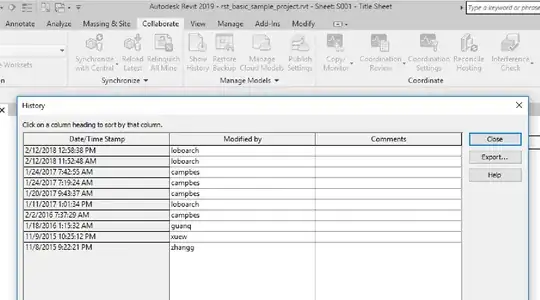

If it helps, this is a screenshot of what the history looks like for an example Revit file. I would guess it's stored simply in the History file, but I can't really tell.
