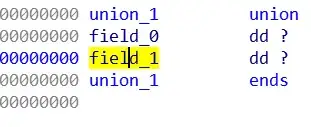

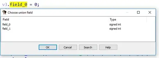

I don't think there's a way to add a new function variable, since the decompiler creates those based on registers and stack locations.
However, in situations where it's really annoying, creating a union type in the Structure viewer can be helpful.
Union Definition
Then, in your decompiler, set the type of the variable to the union type (Y is the keyboard shortcut). variable type declaration
In the disassembly, depending on the variable usage, you can use "Alt-Y" to select the appropriate union field. (it's also accessible in the right click menu) Union field select

  • Good idea. It would not be able to fix displaying of the variable in the second line, where the addressof operator is used on the merged variable (still displays only &pbdfOrLength without any member access), but I guess this is the best solution possible. – Ray May 08 '18 at 20:36
  • Bummer. I didn't realize it would act that way for the address operator. Appreciate the info. – mayahustle May 08 '18 at 21:48
