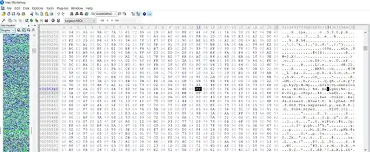

I am trying to reverse engineer my HP printer's firmware, so I dumped the SPI chip from the board, and there are a lot of strings, but almost always look something like this: enter image description here
I noticed a pattern that sometimes after every 8 bytes FF byte is added. However, this is not the whole pattern. Does anyone have a clue what could this be? It is not the dump error since I extracted some JPEG images from uncompressed parts just fine, and multiple dumps produce the same file.
UPDATE: I figured it could be LZSS compression, and I managed to decompress this part and got this. However, when I tried the same script on the other part which has the same pattern it does not decompress properly. What could be the reason?

  • 73
    That is typical for per-character compression such as LZMA (if I remember my abbreviations correct). It was a natural next step up from basic RLE (where a leading value or one or more bits indicate what to repeat). The next step was to compress bits, and in such a case you would not be able to find plain text anymore. – Jongware Feb 05 '18 at 23:33
    Thanks for pointing me in the right direction! It seems to be LZSS actually. I managed do decompress one part of the file apparently correct. But some other parts with the same compression don't decompress correctly. I think I haven't figured out the exact parameters or it could be some LZSS variant... – hlex Feb 06 '18 at 17:20
    Perhaps you could show your current code in your question. It may help if you put in a link to the data as well, so others don't have to re-type it from your screenshot. – Jongware Feb 06 '18 at 17:45
  • Yes, good point, here it is! – hlex Feb 06 '18 at 18:40
  • Can't actually download the 1st sample part in your post, the link isn't set to public. – TkTech Feb 07 '18 at 06:47
  • Wow, I reversed almost this exact algorithm implemented in 65x a while back, didn't know it had a name. You learn something new every day. Maybe I'll try it out on these mysterious KLIB files I've got if it's a standard thing. – sqykly Feb 07 '18 at 08:56
  • @TkTech Oops, now it should work! Thanks for pointing out! – hlex Feb 08 '18 at 01:17
  • @sqykly I am glad it helps, it is relatively standard, there are a few parameters, shouldn't be very hard to figure them out, they said :D – hlex Feb 08 '18 at 01:19
A couple of years of experience later, I revisited this project and figured it out! The compression is in fact LZSS, and the QuickBMS script from my question is able to decompress it correctly. The second section I mentioned was problematic just because there are uncompressed blocks in between compressed blocks in the chip dump, so, obviously, they need to be extracted and decompressed separately.
