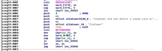

One of the first things that SimTower does is to run WAVEMIXINIT from WAVMIX16.DLL. As far as I can tell, if the return value is 0 it shows a dialog box and disables the sound.
My plan now is to simply create a faux wavmix16 dll that will (for now) always return 0 from that function. That should allow me to get an entry point to run my own code, and get the game started.

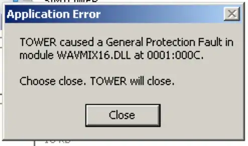

For some reason though, the program crashes as soon as I get to my return statement.
(wine)
Unhandled page fault on read access to 0x0000fa30 at address 0x148f:0x0000000c (thread 002b)
(Windows XP)

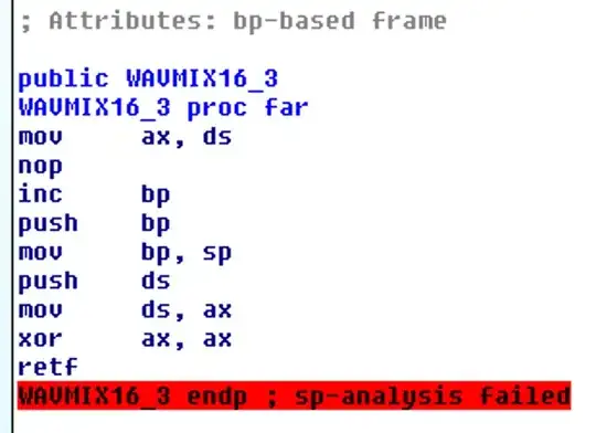

This is the assembly of my DDL function that gets called. I'm a little bit unsure of why there is more stuff than just a mov and retf (like the nop?), but I'm new to all this so maybe that's normal.

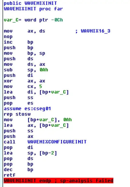

This is the assembly of the original DLL function:

  • To me it seems like my function is pushing 2 values to the stack before returning, and that the original DLL is pushing 6 and popping 4 values (leaving 2 again) before returning, which to me indicates that the calling conventions should be the same... – Linus Unnebäck Nov 07 '17 at 07:41

Your faux function is not fixing up the stack on the epilog of the function. It should have
pop ds
pop bp
dec bp
at the end by the calling convention.
If you look at the original function it fixes up the stack correctly.
Let's say the stack pointer had the value of 1000h coming into the function (after CS:IP is already pushed on the stack for the far call). You would then have in the original function
; sp = 1000h
mox ax, ds
push bp        ; sp = 0ffeh
mov bp, sp     ; bp = 0ffeh
lea sp, [bp-2] ; sp = 0ffch
pop ds         ; sp = 0ffeh
pop bp         ; sp = 1000h
retf
To make the compiler used in the question, the Digital Mars compiler dmc.exe, generate these instructions when returning from a far function, pass the flag -Wm which will "Generate INC BP / DEC BP to mark far stack frames".
