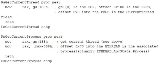

While reading Practical Reverse Engineering by Bruce Dang, I came across the following.
Image from Practical Reverse Engineering
  1. Am I correct in my assumption that the procedures return a pointer to the current thread and current process respectively?
  2. In PsCurrentProcess, the offset into the current thread is 0B8h whereas in the comment it is written as 0x70. I do not understand what the author means by this. In an attempt to find out I tried to debug a x64 Windows 10 Kernel.
I couldn't find any thing at offsets 70h nor B8h. But I did find a _KPROCESS at offset 220h. Is this what I am looking for?
  1. Will this offset be the same for all Windows 10 x64 systems?
  2. I would like to know about the internals of all these structures. Is there any resource that explains all the important internal data structures in Windows from a reverse engineering stand point.

To start with, the offsets are more likely to match the current OS at the time of the book's writing (probably Win7) than Windows 10. That said, a good reference to internal kernel structures over different Windows versions is Geoff Chapell's website: https://www.geoffchappell.com/studies/windows/km/index.htm
For example, looking at KPCR, we can see that at 0x0180 we have KPRCB Prcb;, so 188h is 8 bytes into KPRCB. Checking KPRCB, in turn, we see that offset 8 is KTHREAD *CurrentThread;. So the offset 0B8h should be looked up in the KTHREAD struct. I was able to find on this page the member KAPC_STATE ApcState; at offset 0x70 in x86 version and 0x98 in x64. I'm not sure what OS version is the quoted disassembly coming from, but it looks like there's been some mixup. You should probably submit an errata report on the book's page at Wiley.
In the meantime look at the disassembly of mentioned functions in the kernel you're actually running and then match it against the structs you're printing.

  • Thanks for answering. As adviced, I looked into the dissasembly of the function on my system. The offset to ApcState is 0x98 in x64. It seems to be an array. At an offset x20 into the array is the ApcState.Process. So the effective offset is 98h + 20h = B8. Also after googling a lot I found the terminus project. It shows a nice representation of some internal structures in Windows. Thought you might be interested. – Aswin P J Oct 04 '17 at 04:47
