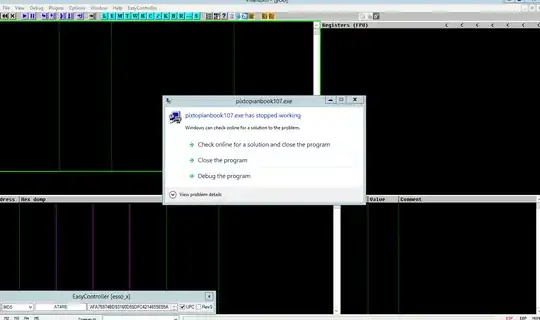

i am solving the leena's 4th binary challenge.but the ollydbg is unable to stop at Entry point which some around 400000 or above.Application stops working and start with some around 700000 check the image below Application stopped working

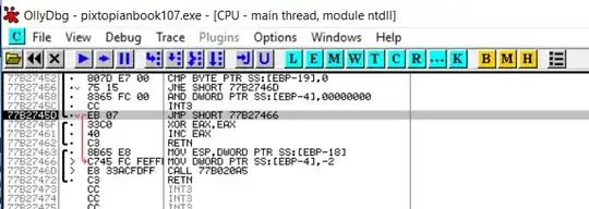

And if we close the application it will stop at 700000 address.check the below image700000 address

OllyDbg has stopped the execution at ntdll!RtlUserThreadStart, what seems like almost the "System Breakpoint" which is the location where the operating system uses to break so the debugger can do its work -- but not exactly there. The address which you are in is inside NTDLL and you have nothing to be afraid of being there.
I believe that there's a bug (or a configuration which I'm not aware of) in OllyDbg in which the program breaks in RtlUserThreadStart although your settings is set to first break on program's entry. RtlUserThreadStart is kind of every thread's entrypoint so I wonder maybe Olly hits this-not-exactly System Breakpoint even though it is not configured to do so.
Both OllyDbg v2 and x64dbg doesn't have this problem and they would break on program's entrypoint as expected, unless you configure it elsewhere.

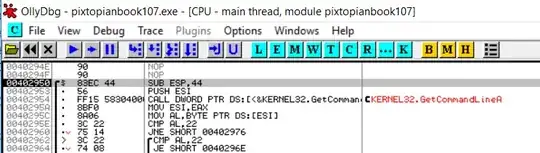

For example, here's the program as it loaded on Ollydbg version 2:
And here's how it looks like when it configure to break on System Breakpoint:
You can configure it by using Alt+O >> Debugging >> Start and check "System Breakpoint" under "When starting application, make first pause at".
As you can see, the program broke on a different address which is considered as the System Breakpoint.

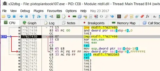

x64dbg also breaks in this address:
You can configure x64dbg inital breakpoints in Options >> Preferences >> Events.
Anyway, in your case, pressing F9 or Run in OllyDbg v1 will take you to the program's entrypoint.
