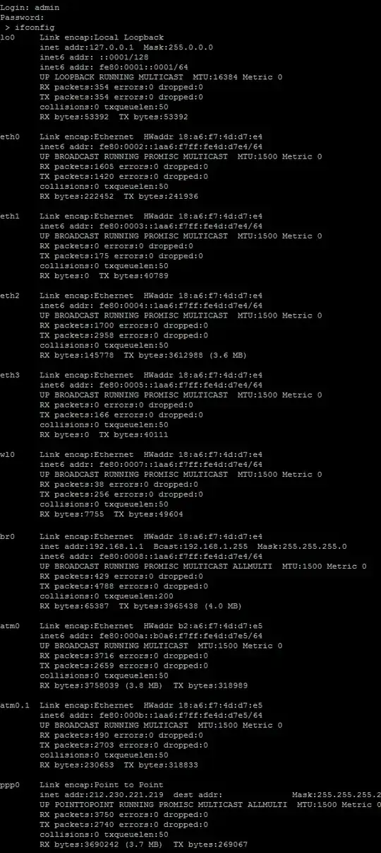

Below you can see the gui setting and the ifconfig from Telnet MTU Gui
MTU Ifconfig
The config files also confirms it should be 1400 on the ppp0 interface: Config MTU

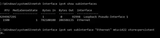

Finally I have set my NIC to 1420 and my navigation issues are resolved. When returning back to 1500 the issue returns. NIC MTU

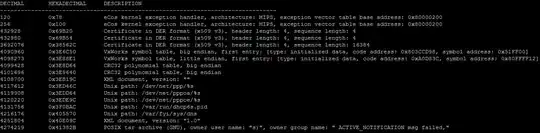

I am presuming that from the binwalk output the file system is ecosFS from the line:
768           0x300           eCos RTOS string reference: "eCosFS"
I have done some research and I see ecosfs is a file system and possibly related to Yffs which I believe Firmware Modification Kit was capable of, but this is the first I have heard of this file system. Can anyone advise what can be done to unpack and repack a firmware like this, are there any tools specific to ecosfs that are necessary?
I have literally turned google purple trying to wrap my head around this and could do with a push in the right direction.
Update 03-08-2017 I can now see (maybe more understand), that the original extraction using binwalk gave me a 7zip file of the LZMA data 6223D.7z. I have extracted this file and I have a data file. If I run binwalk on this I see more mention of eCos, VxWorks and little/big endian. This would lead me to suspect I am getting further.
Ecos Binwalk
