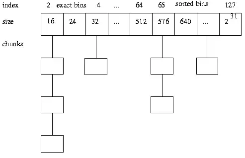

One of the authors of malloc(), Doug Lea, has written an article called "A Memory Allocator" which describes how malloc works (note that the article is from 2000, so there will be some out of date info).
From the article:
Chunks:
malloc chucks
Bins:
binning

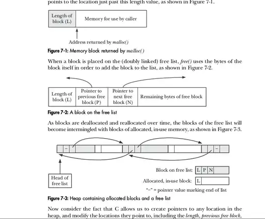

An additional resource is chapter 7: "Memory Allocation" of "The Linux Programming Interface" by Michael Kerrisk. TLPI is the best reference of any type I have ever encountered and cannot recommend it highly enough.
Here is a diagram of the implementation of malloc() and free() from TLPI:
TLPI malloc and free
On a final note, malloc() is a wrapper around the brk() and sbrk() system calls, which resize the heap by changing the location of the program break.
