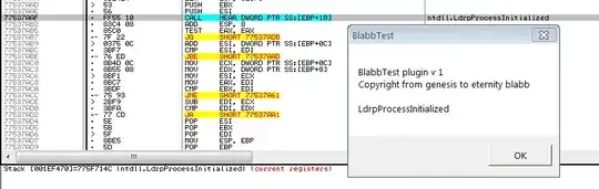

here is a source code for getting the information
usage right click in disassemble window to find men Blabbtest
on execution you will get a msgbox with the name of the api
compiled and linked with enterprise wdk compiler and linker using
cl /nologo /J /W4 /Ox /Zi /analyze /EHsc /LD *.cpp /link user32.lib ollydbg.lib

here is the result enter image description here

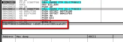

  • Thanks for all your help wit this stuff, finally I've come up with a plugin which will help me to speed up the disassembling of some projects I got in mind, right now my olly environment is quite good. Ideally I'd write a plugin reading content from PWM_INFO but it seems quite time consuming I don't want to spend more time on this task, I see the answer of your other thread doesn't address the question so I'll wait for the author to mail me back (if he decides to do so...) or just him writing proper documentation. In any case, giving you +1 on the other thread for the effort, Have fun you too – BPL Nov 18 '16 at 11:32
  • Just for the record, x64dbg supports this out of the box and ignore you're missing something it's easy to implement. – mrexodia Nov 18 '16 at 21:26
    @mrexodia First time I hear about that debugger, I've looked at it and it feels like it's a much better version of OllyDBG, plus it's open source, I don't see any reason why i should stay with the good old Olly anymore. Active community/development... what else? Thanks for this good advice! – BPL Nov 20 '16 at 10:56
