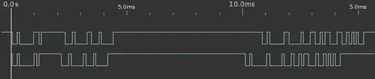

Having the feeling something in the transmission could be wrong, the rs485 chip on my usb dongle and the one on the keypad are different (sipex sp485ec keypad - st 485ecdr usb dongle), I tried to tap directly a logic analyzer to the serial pin on the microcontroller. Doing this I verified that sending bytes through my usbdongle I could receive them on the pins on the MCU.

I ended up probing serial data, directly on the MCU serial pins tx and rx pins, that because I feared the rs485 driver could have something wrong.
At last, comparing a sniffed waveform from original MASTER and the waveform I produced I finally saw the difference. waveforms comparsion Now I can successfully transmit bytes to the devices on this bus and proceed with my original goal of reverse engineer the protocol to use this hardware on my custom Anti-theft system.
