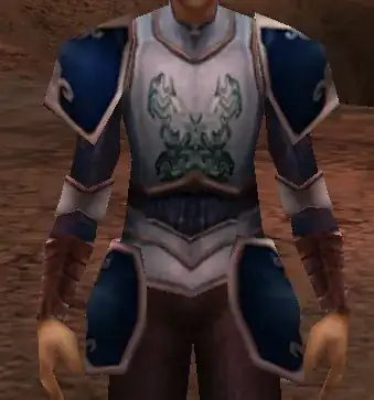

The Armor of Eagle in-game:

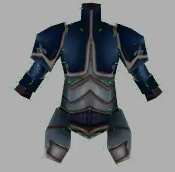

f 5/5/5 6/6/6 7/7/7
I finally got this:
Although it's still wrong, I guess I'm a bit closer.
FINAL UPDATE
Have figured it out. Although, I still don't know what the unknown1 and unknown2 are but it looks good enough:

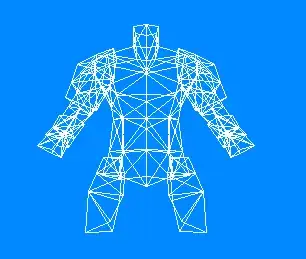

Here is the proof that the first 3 elements are indeed x, y, and z. I plotted x and y only, with y inverted (negative towards the bottom of the screen). You can clearly recognize the 'body' part of your in-game image.
a wireframe body
Not all coordinates are quite the same. The unknown_1 float value is 1.000 for the first 173 coordinates, then jumps to other values for the remainders. Similarly, the integer unknown_2 hovers between values from 4 to 43 for these, and then jumps to a much higher value. This needs some further investigation.
