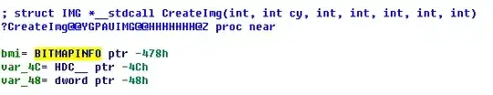

Each item of the list in above picture is either an address where a global variable of type %structure name% (here is BITMAPINFO) is declared or a position where a local variable of type "structure name" is defined. The former is like
example: global variable definition of type GUID (here is type GUID, not BITMAPINFO).
The latter is like example: local variable definition of type BITMAPINFO This is the position where IDA declare local variables based on its identified type.

The xrefs you are showing are xrefs from stack variables. As you mentioned, when trying to get the xrefs to the struct, you get two types of results:
  1. Valid addresses, which are struct instances in the data section
  2. 0xFF000000 and above addresses, where the struct is used as a stack variable.
In IDA the stack variables for a function are represented internally as a struct, with each stack variable a member of that struct.
idaman struc_t *ida_export get_frame(const func_t *pfn);
Docs link
Knowing that, we can infer that the weird xrefs are member-ids (which they are). To get the names of the containing structs we use fullname = idaapi.get_member_fullname(mid) and get something like $ F4014B0.var_14. $ F4014B0 is the netnode name of the stack-frame struct for the function at 0xF4014B0.
