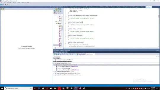

  • enter image description here how can i know the Obfuscator for exe? – kostas1337 Oct 08 '19 at 10:08
You file is obfuscated with ConfuserEX and I know it because of the way the ControlFlow looks. ControlFlow is simply the fact that the method body seems to be confusing / puzzling, with Switch Cases and Gotos. If you dig into Google, and look for "ConfuserEX Deobfuscator" you will be able to download a few tools to clean your protected assembly (mainly on tuts4you's forum).
