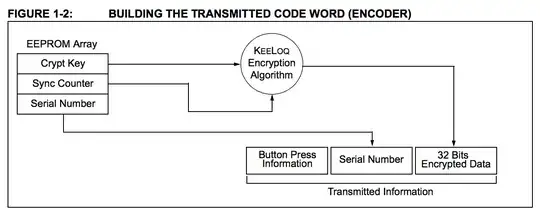

To create a full duplicate, able to generate valid transmission packets you'll need the following information:
  1. Serial Number
  2. Button press mapping
  3. 32 bit of KeeLoq encrypted data
See attached Figure 1-2, from the datasheet, near "Transmitted information" at the bottom right:
Using those three pieces of information you can theoretically create your own device.
This is where shit gets serious, we'll need to know what to encrypt in addition to the key:
  1. Button status.
  2. DISC bits.
  3. OVR bits.
  4. Sync Counter (16 bit word incremented once for every button press in the controller's life span).
  5. Encryption Key (called "Crypt Key" to sound leet in the datasheet :D )

Encryption Key
The A Practical Attack on KeeLoq article describes different vulnerabilities of the KeeLoq encryption espclifically as used for vehicle remote controls and immobilizers. This is a good read if you're interested retrieving the key using cryptanalysis, and it demonstrates several potentially feasible methods. It also reviews related works for your convenience.
