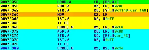

To understand the decryption function, first building blocks of the obfuscation should be understand. So, I picked up some example codes after the second bytes was read out from the input block (the start of the function is a little bit messy because of the compiler optimization).
In the above image the line marked with green reads out the second byte of the input block and the orange line initializes the R2 register. The yellow and blue blocks are perform similar functions. Both blocks starts with an addition, stores the result to a local variable and check whether the result was equal to 0xFF. If the result was 0xFF the value of the R2 was changed. Since the R2 was changed only if the addition was 0xFF and the addition used always the LR (which contained the second byte of the input), the value of the R2 register can be changed only once. Because the new R2 value depends only from the LR these blocks implements a lookup table, which is a substitution box.
[EDIT] The lookup table is built up from the building blocks similar to the highlighted ones. So, in pseudo code, the lookup table is implemented in the following way:
if (input == 0xb1) out = 0x5b
if (input == 0x42) out = 0x56
To understand the reason why the result is stored into a local variable, let's check the next usage of the local variable var_1A8.
It reads out the local variable, which was the result of the addition, and checks whether it is 0xFF similar to the previous cases. Since the value of this local variable will be 0xFF only if the result of the addition was 0xFF in the place, where the value was originally stored, the comparison checks whether the input byte is equal to a specific value again.
If we search for the local variable var_1A8 in the whole function, we receive a lot of results with a specific patter (STR, LDR, LDR, LDR) repeatedly.
The STR means the storage of the addition and the LDR means the usage of this addition. So, every bytes are checked four times and than another byte will be used.
By comparing all of the input bytes usages with the local variable usages, the following patter can be found:
