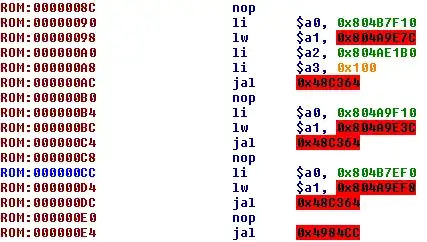

I am trying to figure out how the bootloader of a TP-Link wr702n device (based on an AP121 MIPS board) starts the operation system (VxWorks 5.5.1). The bootloader is extracted from a firmware update file and is a binary (no ELF, PE,...). I am stuck with the next step. IDA Pro disassembles some functions but (I guess) it needs further information about the ROM start address, loading address, and offset to do it properly. Where can I find these information?
I have no RE experience and I am doing this for fun/education. Any hints about further reading or next steps would be great.

As you guessed correctly, you have to find out the correct starting address of the bootloader image. Based on the bootloader in the latest firmware image (TL-WR702N_V1_141203) I recommend you to try 0x80400000 as the start address.
Although I don't know a simple and exact method to calculate the start address I try to explain a little bit more how can you found this anyway.
You can try the following techniques:
  • Identify function starts and pointers to the functions and try to match them. If you disassemble the whole binary, the function start addresses can be determined very accurately. So, you can collect the relative start addresses. In most of the binaries and bootloaders, after the code section you will find various data items such as pointers to functions. If you can identify some of these pointers, you can try to find the corresponding relative address.
  • You can find hints from the code itself. Although the bootloader uses relative branches, the data items are accessed with absolute addresses. In the figure, you can find the absoulte addresses as 0x804B7F10 and so on.
    Based on this address and the length of the code area (0x9B6A4) you may have intelligent guesses, such as 0x80400000 or 0x80408000 or similar.
  • ebux
    • 1,759
    • Thanks for your advice. I had the same idea but the address spread in my disassembly is too big. However, it seems as if my disassembly is wrong. IDA disassembles the area around 0xCC as a bunch of qwords altough the shown addresses, e.g., 0x804B7EF0 appear in my dump at the appropriate place. – user3422070 Oct 15 '15 at 07:41
    • May be some reference pointed around 0xCC in later code, which confused IDA. In this case I disassembled only some function at the start of the binary to see the absolute address references. – ebux Oct 15 '15 at 08:01
