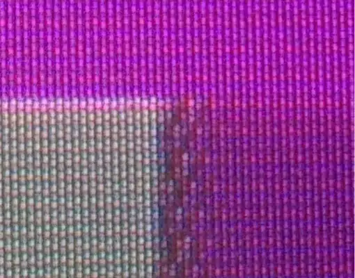

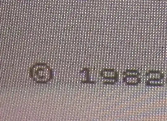

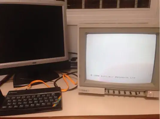

This may answer your question. This is my setup: a ZX Spectrum 48K and a 1084 CRT monitor. The Spectrum has been modded to output a composite signal instead of RF.
And this is a close-up on the picture the monitor shows:
So yes, the Spectrum generated scanlines, but this effect depends largely on the TV set used. My memories are also of a completely pure white screen, without scanlines or other artifacts, but I think that is just because we used to hook the Spectrum to the family TV, and the distance you normally used that TV with was far enough to have the impression of a scanless white screen.
Scanlines happen on CRT screens due to the electron beam actually tracing the scans, left to right, up to down. As the Spectrum had a (almost) progressive video signal, both fields were drawn on the same location and hence, black scans were shown between two lines. The 128K and +2A computers had an even worse (worse = out of norm) signal, which was almost progressive as well.
Curiously, I also have no memory of RF interference on the screen, when there was actually some of it, and that is just because we used to watch TV and that sort of interference was everywhere, so they passed unnoticed to us. It's many years later, with digital TV and noiseless Scart RGB connections when I have realised how crappy the original TV output was.
About TVs averaging odd and even scanlines... well, this monitor doesn't seem to do that. You can clearly see what they call "NTSC lines" followed by "PAL lines". That is: scans with correct phase (magenta), and below them, scans with opposite phase, which are shown as green (I believe).
Between each magenta scan and (green?) scan, you can barely see a small separation, which is the black scanline effect.
