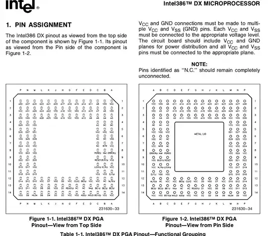

We can see the datasheet of the 386DX here. The most important part is its pinout.
We have address lines from A2 to A31. It means, that yes, it could have handled 4GB memory on a motherboard. Although it is very unlikely, that any ordinary PC motherboard had been built with the required number of memory sockets at the time.
It is more likely, that it was used at most to make memory-mapped IO easier in embedded environments.1
(A0 and A1 are missing, because the cpu could address only 4byte memory operations. Essentially, it was an only 30-bit CPU, working with 32-bit "bytes". This trick is usual since the early 16-bit era.)
For example, the Weitek Abacus FPU was memory-mapped to 0x0C000000. Floating-point calculations could be done by writing the commands into a 64kB-block starting at far higher as any physical RAM ever could end (at the time... 192MByte), and then reading out the result with mov operands.

    Exactly, thanks. It’s worth noting that the 386, while it addressed 32-bit words as you point out, could operate on individual octets by using the bus enable pins (BE0–3). – Stephen Kitt Apr 05 '19 at 13:51
    Why didn’t they reduce the address pins to a more reasonable number? I mean … nobody expected you to have the full 2^32 bytes of RAM back then, right? A2–A24 for 32MiB RAM should have been perfectly sufficient. – Michael Apr 05 '19 at 14:42
    Would be fun to see someone fitting a modern 4GiB RAM module via some type of adapter to a real 386 chip and get it to work. – Ruslan Apr 05 '19 at 14:59
    @Michael I think they had two reasons: 1) they didn't know at the moment, how strongly should they remain compatible with their own CPU sockets of the future. At the time it was yet a real possibility that 586, 686 will be still socket-compatible (or will have at least a socket-compatible version) 2) These CPUs wasn't designed only for PCs, but also for embedded environments. If you access some hardware by memory-mapped IO, it means that you communicate with the chip with memory read/write operations. Essentially, the CPU can see the chip as if it would be a memory module. – peterh Apr 05 '19 at 15:15
  • @Michael Now the problem is that you can't convince the all the chip manufacturers of the today and the future, to be nice and compatible with your CPUs, and wire their chips to the params you would like to have. So they've needed maximal flexibility. Thus, if you have a 32-bit bus, you need to have 32-bit pins (well, 30). – peterh Apr 05 '19 at 15:16
    @Michael The 386SX did that... it narrowed the address bus to 16MB, which was much more realistic in terms of installed RAM. On 386DX hardware, there were also products like the Weitek 1167/3167 FPU's that were memory mapped into addresses way beyond 16MB. (These devices accepted their instruction stream over the address bus, in fact.) – mschaef Apr 05 '19 at 15:30
  • @Michael An example: Weitek Abacus FPU was a floating-point coprocessor, but it was visible as if it would a 64kbyte RAM block at 0x0C000000. You wrote your commands into the memory addresses, with mov operands, and then read the result from them. It was much faster than the 387. – peterh Apr 05 '19 at 15:38
    Having extra address lines available can simplify decoding. If, for example, some devices are are 8 bits wide, some 16, and some 32, and if some devices require wait states while others don't, one could use four address lines to control such things and still have 256MiB of address space available. If one started with only 24 address lines, using four for such purposes would leave only 1MiB of address space available for each combination of memory width and speed. – supercat Apr 05 '19 at 19:14
