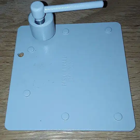

Stumbled into this thing while cleaning up my basement. A density doubling disk notcher. A 3½ floppy is placed face down, turning the handle acts like a vise to press down the hole punch.
DISK WIZARD
Pat. pending
Made in Canada
Stavr00
