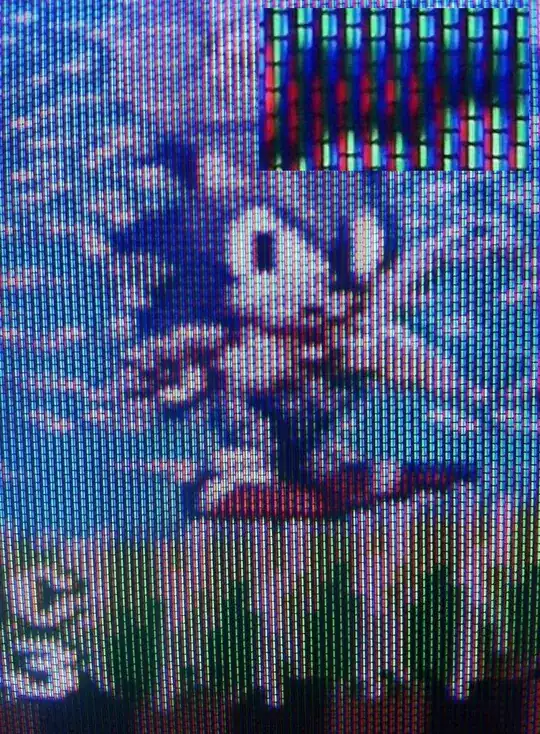

with thanks to Tommy, here is an image from an actual CRT. In the upper right there is a zoomed in area from Sonic's foot, which shows some of the vertical bars that people often assume are pixels are in fact not evenly lit. The tops and bottoms of some of them are at different brightness levels.
The bars you can see are actually the shadow mask, and are unrelated to pixels. They define the maximum horizontal resolution that the CRT is capable of resolving, but even then the relationship is not 1:1.

    "CRTs don't have pixels, they don't work that way. " What does that mean? The screen, at least on color CRTs, is separated into discrete regions. – Acccumulation Mar 22 '19 at 14:44
    @Acccumulation see https://youtu.be/Ea6tw-gulnQ but basically what you see on the TV is the result how it produces colour via different coloured phosphors and masking, not pixels. – user Mar 22 '19 at 14:55
    @Acccumulation The red, green, blue phosphors, the discrete regions, on a colour CRT don't have any correspondence to the pixels being generated by the arcade machine's video circuitry, and it's these pixels that the original poster is talking about. –  Mar 22 '19 at 17:56
  • @Acccumulation: A CRT may have 480 horizontal lines making up the vertical resolution, but each of those lines has theoretically infinite horizontal resolution because the signal is analog. However in practice the horizontal resolution is limited by the TVL, which could reasonably be called pixels. – BlueRaja - Danny Pflughoeft Mar 23 '19 at 04:27
  • @user I'm really unclear as to what the point of that is. My best guess is that each discrete region can contain detail (different parts of the region can have different brightnesses), as opposed to a pixel having to have the same brightness throughout the region. Is that what you and/or TC is saying? – Acccumulation Mar 24 '19 at 04:14
    @Acccumulation the "regions" are just holes in the shadow mask. That video explains it better than I can here, but they are not pixels and don't have to be uniformly lit. The beam intensity is analogue and the limit on resolution is more to do with the limitations of the electronics than the "regions", which are just holes in the shadow mask. There is no correlation at all between them and pixels though, unlike an LCD monitor. – user Mar 24 '19 at 12:39
  • @Acccumulation : Why do you think an entire phosphor lights up when some part of it is illuminated by the electron beam? A monochrome CRT is not a one pixel device. Full screen width horizontal phosphor striped CRTs were patented, but I don't know of a commercially successful one. – Eric Towers Mar 24 '19 at 19:37
    If it helps, see https://2.bp.blogspot.com/-swPay7tztq4/XJMFpkj3h0I/AAAAAAAABaU/nC2zH89zTOkBT0GJ7Sh1WZo-AxaL4KRIgCLcBGAs/s1600/IMG_2697.jpg for a shadow mask in action. In particular, zoom to 1:1 scale and check out e.g. the bottom of Sonic's shoes. You'll notice that the hard black line goes through the middle of many of the individual colour pools, demonstrating that they're not pixels. I took that picture myself, on a real CRT, so feel free to crop and/or embed in the answer if you think it's helpful. – Tommy Mar 25 '19 at 14:20
