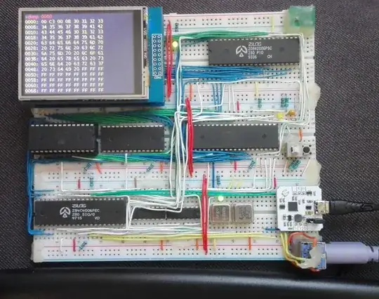

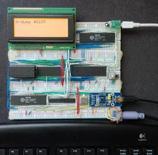

Just use Z84C40 SIO chip. SIO stands for Serial Input Output. It's a part of standard Z80 family chips and has two channels. I used it for PS/2 keyboard and USB connection to my breadboard Z80 computer running at 2.4576 MHz. Z84C40 can divide system clock by factor of 16, 32 or 64 thus I run my UART-USB bridge at 38,400 baud without use of 4-bit counter as system clock divider. Luckily PS/2 keyboards generate clock themselves. So all you need to connect a keyboard is this chip and PS/2 connector (female).

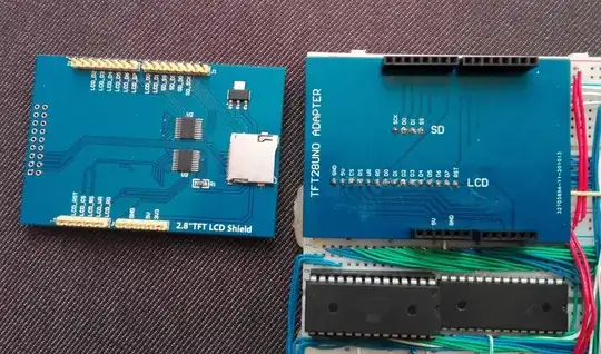

LCD 20x4 chars

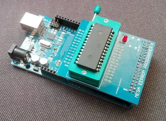

Update: I have finally made adapter PCB for 2.8" TFT Arduino UNO shield which provides back compatibility with previous LCD screen (no need to rearrange connection wires). Also I've made a convenient EEPROM programmer shield for Arduino MEGA. So now I have a lot of fun coding my Z80 breadboard machine which now runs at 10 MHz. Also there is 7.3728 MHz clock generator for UART-USB bridge (115,200 baud). TFT 320x240
TFT shield

    That's a beautifully simple design. Do you have a writeup somewhere? – occipita Oct 09 '20 at 03:21
  • this is pretty much exactly what i was planning to build, if there's any schematics/writeup/blogposts/whatever about it i could take a look at to save me some headache, that'd be extremely appreciated :) – nonchip Oct 10 '20 at 21:17
    Well.. my design was inspired by Ben Eater's one (youtube blogger), but his system is based on 6502 CPU and still is not completely developed. I didn't post yet my Z80 system anywhere but here. I probably could draw some schematics, but it would be kind of spoiling all the fun for you. As far as I understand, the essence of this kind of hobby is not to just GET a retro system, but to elaborate the design by yourself, build it and make it work. Besides my design is so simple and straightforward so there's practically nothing to explain, just get the chips and download corresponding datasheets. – Georgy Batog Oct 12 '20 at 01:03
  • @GeorgyBatog was thinking mostly about the SIO part because i frankly have no clue how PS/2 actually works, if you have any pointers for that that'd be really great :) the remainder is already kinda planned out on my end, got the z80, some rom, some ram, some GALs for bank switching and address decoding magic, my clock is a canned crystal resonator w/ integrated driver because i'm lazy, and for debugging i'll have an stm32 bluepill, but i wanna phase that out as soon as possible (don't like a stronger computer being IO for the one i'm actually working on) which is why i'm looking for the PS/2 – nonchip Oct 12 '20 at 14:56
  • @nonchip I think you won't have any problem with finding datasheet for SIO. The chip id is clearly seen on the photo. Just prepare to have some mess with SIO setup registers. Also you gonna need a PIO chip for parallel interface i.e. display. Initially I used LCD 20x4 chars, but now I'm switching to color TFT 320x240. Right now I'm considering to use leftover pins of PIO for driving SD card reader embedded into my TFT module. Concerning GALs for address decoding you gonna need only NAND and NOT. Not sure about bank switching in such a system.. 32k "ought to be enough for anybody". – Georgy Batog Oct 12 '20 at 20:55

    @nonchip You can find some writeups now on extended modular PCB version of my design. – Georgy Batog Dec 04 '21 at 15:14
