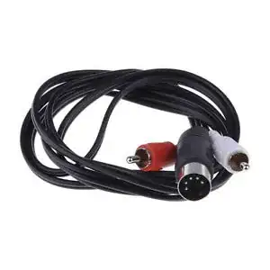

After discovering my old Commodore 64 in the garage, I wanted to test if it still works. The power light comes on but the video connection to a modern TV is obviously an issue, as mentioned here. Well I bought this cable from ebay, and although it is red and white, it is sold as an audio/video cable, and not just audio. But I'm not picking up a signal, so either the item was misleading in its description of video, or my commodore 64 isn't working. Does anybody have experience with this cable?
A circular plug with five adjacent pins, spaced in a circle in a way that would be even were there three additional pins; attached to two (probably) 3.5mm jacks. One jack is red, and the other is white.
(source: ebayimg.com)
Thanks for everyone's contribution on this. So based on the C-64 AV jack pinout as provided by Janka, each pin was tested using a multimeter to see which pin may be connected to which colour lead, and it seems red is video and white is audio. I think this confirms Brian's suspicion that the cable is OK, and I remember basing my purchase on similar ideas. Hence it does seem most likely that there is an issue with my C64 video. I can actually hear a faint sound when I turn it on, so the audio may be OK. Of course it's difficult to say definitively without having a working C64, but currently I'm going through some options, including all those suggested by Brian.

  • Hardly to call that keyword cloud a description at all, or is it? Fastest way would be to check the wireing with a ringer. Going by the comours there's a good chance that it's just for audio anyway. – Raffzahn Dec 24 '18 at 12:19
  • Welcome to Retrocomputing Stack Exchange. Thanks for the description of your problem. It's possible that one of those cables is carrying a video signal; have you tried plugging them one by one into the yellow hole? But it could just be a misleading description. – wizzwizz4 Dec 24 '18 at 12:26
  • I would expect to see a yellow connector for video. Maybe the seller noticed that C64 uses the same DIN connector and thought it was compatible. – snips-n-snails Dec 24 '18 at 17:39
    I have a similar cable that I use on my C64 and it works just fine. You are connecting the red plug to the yellow jack on the TV, right? – Fred Larson Jan 03 '19 at 21:36
You have to check if this is the correct cable. Unfortunately, the DIN connector the C64 uses for it's A/V output is similar to the DIN connector used for tape playback/record on old audio hardware.

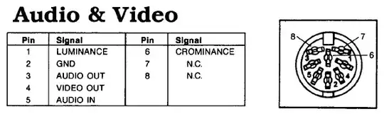

C-64 AV jack pinout: C-64 audio and video jack pinout
Audio Out (Pin 3) is line level (2V peak-to-peak) and Video Out (Pin 4) is composite video (either NTSC or PAL).
Pin 3 and Pin 4 of the DIN jack have to go to the center pins of the RCA jacks and Pin 2 to the outside of both jacks.
More details on the jack and its signals can be found here.

    If the pinout of the cable is incorrect it should be a fairly simple matter to correctly rewire it since, IIRC, DIN plugs are usually easy to open. If you're really lucky you might be able to simply pull out the erroneous pins and insert them in the correct positions. If not they can simply be resoldered. The extant wire connections can be determined by buzzing it out using the "continuity" mode on a multimeter (or "resistance" mode if you don't have it). – Alex Hajnal Dec 24 '18 at 22:44
  • Just to clarify: Is that the pinout for a C-64 compatible plug? Or is that a C-64 jack pinout? – Alex Hajnal Dec 24 '18 at 22:50
  • It's the socket pinout. You can see this from the clamps shown there. The plug has pins. – Janka Dec 24 '18 at 22:53
  • That's what I reckoned. I've updated your answer to clarify that. – Alex Hajnal Dec 24 '18 at 22:55
  • The cable in question seems to have a molten sleeve on the DIN plug. You cannot open it. – Janka Dec 24 '18 at 22:55
  • Yuck, that sucks. Dremel time? – Alex Hajnal Dec 24 '18 at 22:56
  • The OP's 5 pin plug will fit in the 8 pin socket in this post, but there will be no connection to pin 6 (Chrominance) which doesn't sound like good news! (Pins 7 and 8 are unused so no connection to them doesn't matter). The OP's cable looks like a standard audio-only cable to me. – alephzero Dec 25 '18 at 11:18
    @alephzero Pin 4 provides composite video (either NTSC or PAL) and pin 2 provides ground so a 5-pin plug can be sufficient for video (and audio) output. C and Y (pins 6 and 1) are only required for S-video (and are optional for SCART). source – Alex Hajnal Dec 25 '18 at 22:24
You most likely have a problem with your C64 video.
Based on the fact the eBay seller of the cable in question has apparently sold over 100 of them, and has a high positive feedback score, I think it's a reasonable bet that the cable is fine. I will also give you the benefit of the doubt for having tried both RCA plugs into your TV's video, since the red/white coloring gives no clue about which plug is video and which is audio.

Your TV may not recognize the C64's video signal.
The C64 video signal is, technically, 240p. Some chips have issues with this. This can also be observed with quite a few Video->HDMI converters.
DIN<->RCA adapters come in different configurations. The DIN standard always has ground on pin 2 (the low middle pin - I will describe the pin assignment looking at the male plug so it forms a "smiley face"). The left two pins are the "record" pins, where audio goes into a device, the two in the right are the "play" pins where audio comes out of device. Except for a receiver (radio/amplifier combination), where "play" and "record" are switched. So...just taking any random DIN<->2RCA adapter may give you "play" cable, a "record" cable or a mono "play/record" cable. Yes, most DIN adapter cables you will find are meant to be used for audio, not for the C64.
The best way is, of course, to solder your own cable (or, in a pinch, cut apart RCA cables and shove the wires into the DIN socket).
For simple composite video (no S-Video) and audio, you can purchase a DIN<->RCA adapter with four RCA jacks. One will be color video, one B/W video, one audio...and the one which remains will be audio-in. On the audio-in connector, you can connect the center pin to the rim (shortening the signal pin to ground) in order to somewhat reduce noise on the audio channel (usually not worth the effort).
Klaws
  • 521
You quite likely have a cable specific to certain monitors which used a pre-cursor to S-video. One RCA outputs the tone, Luminance and the other the color, Chrominance. Some cables with the same Commodore input may instead output composite video depending on what pins are connected.
