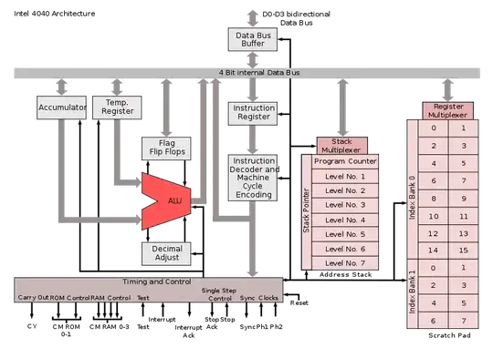

The Intel 4040 processor may well have been the last commonly used sub-8bit processor. Intel produced this series 1974 and 1981. It had a 4-bit architecture (i.e. register size) and generally used Binary Coded Decimal (BCD) arithmetic and I/O. Intel 4040 architecture (Diagram from Wikipedia)
The Intel Intellec MCS 4/40 Microcomputer Development System was based on a 4040 processor, had text I/O based on a TTY interface, and PROM program memory. Note that the program memory was 8-bit, but the data RAM was only 4 bit, as were the registers and ALU. Intel referred to both addressable the 4-bit and 8-bit memories as bytes.
As to last computer in active use, who knows? There are definitely working examples of several of these architectures in places like https://livingcomputers.org
P.S. Other 4-bit processors are still available for purchase today, e.g. Renesas 4508 group.

  • I don't know that the Intel 4004 has ever been used in a Von Neuman architecture except possibly in a few development systems. Four-bit microcontrollers with ROM built in have been common for a long time. The electronic games Merlin and Simon were both based on four-bit microcontrollers, for example. – supercat Oct 12 '18 at 21:00
  • @supercat, I agree a 4004 was not a von Neuman computer, but used the Harvard architecture. Harvard architecture machines however are generally regarded as a computer as they perform calculations from a stored program. – Burt_Harris Oct 12 '18 at 21:10
  • @Burt_Harris: Except in a few development systems, the 4004 would use ROM for its program store. While one could build a 4004-based machine that would allow the user to supply a program (e.g. via pluggable cartridges) I don't think most 4004 machines were wired in such fashion. – supercat Oct 12 '18 at 21:17
  • @supercat, I agree ROM was the typical in production applications. But as you say there were 4040 development systems and which supported self-hosted assembly language programming. As I remember the MCS 4/40 was essentially a modified Harvard architecture with READ/WRITE program memory accessible as data. I think this development system meets the OP's recently updated requirements for having text I/O. I've updated my answer to include details. – Burt_Harris Oct 12 '18 at 21:48
