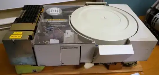

In 1981 I acquired an IBM 5444 from an old mainframe computer. Luckily I also got the service manual for it, and so was able to design a controller board to interface it to my Sinclair ZX81. The interface circuit only used about a half dozen TTL chips and was quite simple, but the ZX81's clock frequency was slightly too low so I had to disable the drive's bit rate lockout (just had to cut a track on one of the SLT logic boards).
At a data transfer rate of ~6uS per Byte it took less than 120ms to load or save the ZX81's entire 18kB RAM, and that was the extent of my 'file system'. Each 15" removable cartridge had ~2MB of storage capacity so it didn't matter that this method was somewhat wasteful.
While this setup worked well it was quite unwieldy. According to a warning label on the drive it weighed over 25kg, but it must have been a lot heavier than that because I almost put my back out trying to lift it. I also had to build a big power supply to produce the several voltages it required, including 24V at 6A.
I dumped the drive many years ago, but here is a picture of a similar one.
