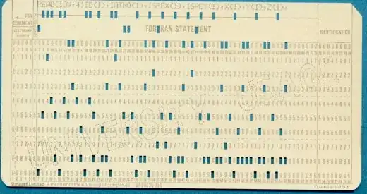

On the basis that a picture is worth a thousand words, I include my scan of a punched card:
As amply described in the other answers, it shows how the columns are visibly marked on the card for different purposes. It makes sense when you see a card. It makes less sense when you're using a computer display or are using paper tape!
  • Yeah, tab-stops on a picture of a display are hard to see :)) Also, paper-tapes never played a role on mainframes - that's a thing of cost sensitive minis - which developed years after these column standards became such. – Raffzahn Jun 28 '18 at 17:19
  • @Raffzahn Correct that paper tapes were much more of a minicomputer thing, not mainframe. But the technology of paper tapes goes back to the 19th century (along with punched cards). Not sure exactly why, though one reason may be the interactive nature of minis vs. batch mode of mainframes, at least in the early days. – manassehkatz-Moving 2 Codidact Jun 28 '18 at 18:55
  • @manassehkatz It may have been more abudget issue. Mainframes where usually installed in a working punch card environment - or at least came with all neccessary punch card equippment available - and a well defined tool chanin around punch cards. Minis in contrast grew in a quite cost constrained envirionment. In laboratories and departments happy to afford the CPU, and no money to buy punchers, sorters and readers. So cheapteletypes and connected punch tape it was. Further there wasn't the same need for high thruput punch cards offered. – Raffzahn Jun 28 '18 at 19:08
  • @Raffzahn All true. But I also think in terms of minis being the typical teletype-as-main-access point type of system. So using the tape punch/reader as part of a teletype is a natural extension and doesn't take away from the interactive nature of the system. Whereas punch cards were strictly a batch mode process - even if you sat at a keypunch to type up a program (which I thankfully just barely missed having to do when I was at Univ. of MD in the 1980s) you HAD to use a different device to actually input the cards into the computer. – manassehkatz-Moving 2 Codidact Jun 28 '18 at 19:18
  • @manassehkatz Even with mainframes one did work interactive already in the late 60, and using punch cards for programm or job entry was soo, restricted to existing procedures and rare task. The switch happened in the early/mid 70s - so about the same time minis came in numbers. Difference was again cost and size. Where minis had just one or a few TTYs (real or glass), mainframes had dozends to hundret terminals at once. already in the mid 1970s, when I started, noone was using a keypunch anymore - except students at universities that is. – Raffzahn Jun 28 '18 at 19:39
  • @Raffzahn When I started at Univ. of MD, I think there were a few courses for non-CS majors that used punched cards and there were plenty of terminal rooms with mostly ADM 3As and similar terminals and some Decwriters - with almost everything running in TTY mode. By the time I left, the terminals were gradually being replaced with IBM ATs, most of the terminals were running 3270 emulation via a Series/1 and the punched card equipment was for a few professors bringing in dusty old card decks. – manassehkatz-Moving 2 Codidact Jun 28 '18 at 19:52
    @Raffzahn: I wonder to what extent paper tapes became popular with minicomputers because they were built into teletypes like the ASR-33? Even if a system has a disk drive, the code required to fetch and execute a block from disk may be over a hundred bytes. Entering that code using panel switches may be rather a nuisance. By contrast, a loader to receive a hundred or so bytes from a serial port can be under two dozen bytes. Entering that from panel switches, and then having a program on tape which boots the disk may be much more convenient. Even if the tape operates at 110 baud... – supercat Jun 29 '18 at 15:47
  • ...waiting ten seconds for 100-byte boot loader to be loaded from tape may be much more convenient than entering it by hand using panel switches. – supercat Jun 29 '18 at 15:48
  • 1000 words? Surely that would need a card with space for 16,000 holes... – Neil Jun 29 '18 at 16:04
