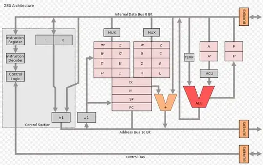

Looking at the Z80's architecture diagram, there is the obvious register file in pink near the middle of the diagram. But four of those registers are not usable by programmers. Those are W, W', Z and Z'. So what operations did these registers participate in if they were not part of any program that could run on the Z80?
First of all there is no W'/Z'. There is only a single W/Z pair (*1).
Second, of course they are usable by programmers. They get used with every 16 bit value, much like TEMP and ACU or the Instruction Register (all the way on the left side) is used with every instruction.
The W/Z register pair is used for temporary storage. Without it, no program using a 16 bit address could be used.
The primary use of W/Z is to hold an operand from a two or three byte instruction until it can be used. The mechanics around W/Z are inherited from 8080 times as they feature the same design (*2) and work exactly alike (*3).
Instructions with an absolute (*4) address will have to read this address during M2/M3, but don't need it before M4. So they have to save them somewhere. Lets take the memory cycles of a LD A,(1234h) (load A from address) as example:
M1 -> Output 'PC'; Fetch Opcode (3Ah) into Instruction Register
M2 -> Output 'PC'; Fetch Lower Address Byte (34h) into `Z` Register
M3 -> Output 'PC'; Fetch Upper Address Byte (12h) into `W` Register
M4 -> Output 'WZ'; Fetch Data Byte at 1234h into `A` Register
There are a few special cases:
The jump (JP) instruction does not load WZ into the PC, but fetches the target instruction in M4 much like a data byte and then loads PC with WZ+1 (through the PC incrementer). Call works similarly. (*5)
16 bit loads (e.g. LD HL,(1234h)) do use WZ+1 to load the second (higher) byte in M5.
All exchange with (SP) (e.g. EX (SP), HL) do load W/Z with (SP+1)/(SP) during the exchange.
(there might be more; I just don't remember).
Further Reading: Programming the Z80 by Rodney Zaks describes this in great detail on page 87-91 (Get the PDF here).
*1 - This picture holds a number of errors, not just the doubled W/Z, but also mispositioned incrementers and alike.
*2 - Intel's 8085 inherited them as well.
*3 - Differences are only due to Z80-specific extensions like additional 16-bit instructions, but also Interrupt Mode 2 where W is loaded with I and Z with the external supplied vector.
*4 - Explicit in Z80 terms.
*5 - And both (JP/CALL) show a nice dance around the WZ-pole when an interrupt happens. Now, instead of loading the PC with WZ+1 the increment will be suppressed and WZ goes directly into PC. Next WZ is loaded with the interrupt vector to be used (depending on the interrupt mode active) - before continuing with the execution exactly like a call i.e. by pushing PC, fetching the first instruction via WZand transferring WZ+1into PC (IFF1/2 handling happened during interrupt acknowledge) - what a beautiful move, isn't it?

Found here, Down to the silicon: how the Z80's registers are implemented:
The WZ temporary registers The Z80 (like the 8080 and 8085) has a WZ register pair that is used for temporary storage but is invisible to the programmer. The primary use of WZ is to hold an operand from a two or three byte instruction until it can be used.
Edit: also worth noticing:
The diagram shows a separate incrementer for the refresh register (IR), an adder for IX and IY offsets, and a W'Z' register but those don't exist on the real chip

    In that case, why is there W and Z in both register sets? – Omar and Lorraine Jun 06 '18 at 13:33
    It's a mistake. There is no W'Z'. – followed Monica to Codidact Jun 06 '18 at 13:41
  • also found in the text: "The diagram shows [...] a W'Z' register but those don't exist on the real chip. " – Tommylee2k Jun 06 '18 at 13:45

  • I think the diagram also errs in the placement of prime registers in general; B, B' D, D', H, and H', IXH, IYH, SPH, and PCH all sit together on one half of the bus, while C, C', E', E', L, L', IXL, IYL, SPL, and PCL all sit together on the other half. – supercat Jun 06 '18 at 14:57
