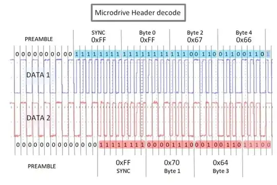

Both the Sinclair ZX Spectrum's and the Sinclair QL's microdrives (their microtape units, which are basically the same thing in both computers) use Differential Manchester Encoding to store data on the tape.
Obviously, these devices didn't actually use audio cassettes, but rather much smaller microdrive cartridges that contained (presumably) high-quality video tape. So, apologies if this only marginally answers your question.
Data is stored on alternate tracks. A 0 is encoded as a phase shift, a 1 as a non-shift. The microdrive encoding/decoding circuitry including the (assumed) PLL is realized in a custom ULA.
(Picture courtesy of QL-Forum)
