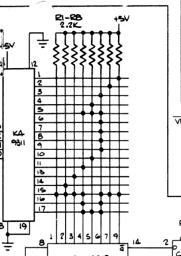

Nonetheless, it is possible to have excess capacity without using ROMs. But such hand-rolled solutions will naturally avoid wasting components. Consider the arcade game Space Race. Here's a screenshot of it in action:
Space Race with two little rockets
The game does not have a ROM. Instead, it uses a grid of wires to represent the rocketship picture and connects them wherever there is to be a white dot. You can see it this subset of the schematic:
Wiring Schematic
Isn't that just wonderful? Notice how not a dot is wasted. They were even clever enough to lay down only half of the rocketship and use extra circuitry to display the mirror image of it to draw the right side of the ship.

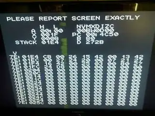

Let's look at a memory map and crash in the production version of MechWarrior for the SNES:
MechWarrior Memory Map
Ideally, this screen will never be shown in production under normal circumstances (without directly modifying the hardware and/or software), and could potentially be considered inaccessible content.
The idea of using/logging memory locations, or presenting this type of memory map to the user is a benefit of using ROM-based memory over diodes.
