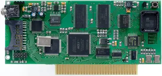

Here is an example of ZX Spectrum-related thing: http://nedopc.com/gs/neogs_c_front.jpg This is a sound card for russian clones of ZX Spectrum (those that have ZX-Bus slots, ZX-Bus is an improved version of 'rubber ZX' bus, allowing multiple cards). It is called 'NeoGS' and based over the older one, 'GS' (stands for "General Sound"), that played 4 channels of digital 8-bit sound using on-board Z80.
The improved NeoGS is FPGA-based and also has SDcard slot and mp3 decoder. DMA via BUSRQ/BUSACK for its on-board Z80 is used for fast access from host ZX to card's memory, thus making it also suitable for co-processor actions like 3D precalc etc. On-board Z80 runs at frequencies up to 24 MHz (slightly overclocked, also 20 MHz mode is supported).

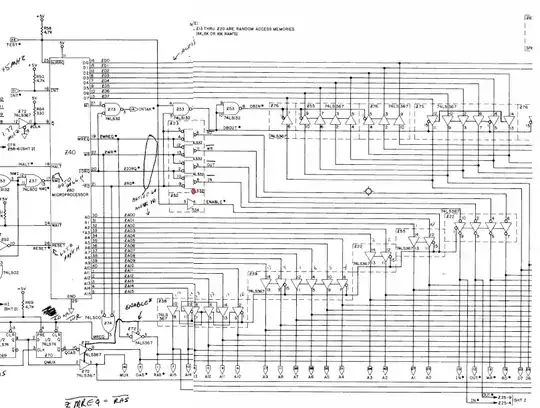

Well, here's an example, IMHO, of how NOT to do it.
This is a segment of the TRS-80 Model 1 schematic. (it's stitched together from two pages from here).
If you find the BUSRQ pin in the upper left, it's tied to a TEST input.
Follow the line around, and you'll find that it's connected to a set of Tri-State buffer chips.
As soon as you send the BUSRQ low, it tri-states out the entirety of the Address and Data bus. Immediately. It doesn't wait for the BUSAK, it doesn't wait for the CPU to finish, it just cuts the CPU completely off mid-anything and everything.
Obviously, this is labeled TEST, so they used it for testing purposes in an (ostensibly) controlled situation. My father discovered this when he wanted to do some expansion to the TRS-80, and perhaps some DMA, but found this little bit making the BUSRQ mostly unsuitable for actual expansion. Things like this went in to his "They did WHAT?" file.
It's not kind to the CPU to just up and yank it away from its whole world on a whim.
TRS Schematic
Will Hartung
  • 12,276
  • 53
  • The purpose was probably to allow an external controller to probe the memory bus of a system that might have problems that would make normal code execution impossible (e.g. a shorted or open data line). Back in the days when non-working boards would be repaired rather than junked, an ability to have a program running on another machine examine the memory of a device under test without interference from that device's CPU would be very useful. I'm not sure that BUSRQ was necessarily more useful for that purpose than RESET, but it avoided the need to add extra logic on the reset line. – supercat May 30 '18 at 22:50
