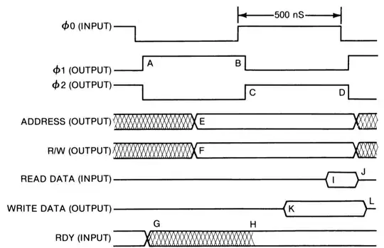

The 6502's memory cycles always last half a cycle. It does only one per cycle, leaving the bus unattended for the other half. But it always fetches at least two bytes per operation: it reads an operand regardless of whether the instruction needs one. If the instruction didn't need one, that read was wasted — it doesn't repurpose the operand it didn't need as the next operation and somehow save an access cycle.
Therefore the shortest instruction is two cycles long. Exactly half the shortest instruction of a Z80.
The 6502 also isn't always actually ready for the next memory access cycle after receiving the prior. In that case it'll do a read or write that it believes to be redundant. So it has less granularity in buying itself pauses in bus access. An example is anything read-modify-write. The 6502 will read, then perform a redundant read or write cycle of the original value while calculating what the result should be, then write.

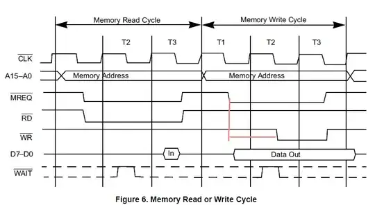

  • Any physical memory (or I/O port) access in Z80 lasts two clock cycles. This means that the RAM speed may be twice lower than the CPU speed with no additional delays.
  • Z80 accesses the bus only when it needs to. So there are cycles when the CPU does not accesses the bus at all and they can be used for other hardware without any additional performance penalty.
UPD. Thanks to @Raffzahn I checked 6502 bus cycles more precisely and found out that if it runs at 2 MHz it leaves 290 ns only for the memory to be read. I.e. it requires a 3.45 MHz memory. And it leaves only a half of the cycle (i.e. 250 ns) for the memory to be written to. This means that it really requires two times faster memory than its own clock.
Z80 on the other hand waits 1.5 clocks when it reads instruction and 2 clocks when it reads or writes data. This allows 4 MHz Z80 to use 2.67 MHz memory for instruction fetching and 2 MHz memory for other operations. Since most memories perform write operation slowly than the read one, we can say that if we have a specific RAM we can use it with Z80 that runs four times faster than 6502. And since it was the RAM speed that was the bottleneck of computer building at times of Z80 and 6502, a computer with Z80 was faster. Also Z80 system benefited from hardware and software simplicity.

    @Kde yes, it does require memory better than 500 ns (2 MHz) to run a 1 MHz 6502. Addresses are valid at the rising edge of Phi2, while the data to be written is valid at the falling edge - or sampled at that point when reading. Do in reality it needs 470 ns or better for a 1 MHz 6502. – Raffzahn Sep 18 '19 at 20:28
