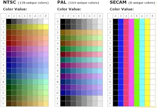

My question is kind of twofold. Why is the SECAM palette so garish and ridiculous, and why are there only 8 colours?

    This is a comment rather than an answer since I don't know for sure, but I believe:
    1. SECAM encoded colours in a fundamentally different way to NTSC and PAL (which is effectively just an improvement on NTSC using similar ideas).
    2. This might have been harder to implement in hardware.
    3. It was not considered worth trying harder just for the French and Soviet markets.
    4. The colours are garish simply because they are red, green and blue maxed out in different combinations.
    If anyone has more time to do research on this, feel free to steal bits from my comment in their answer.
    – Muzer Oct 17 '17 at 10:28

37
The TIA manages a very large palette on NTSC and PAL systems because it takes advantage of the way that composite colour is encoded: three bits produce luminance, and the colour subcarrier is always exactly the same sinusoid, but four of the other colour bits set its phase.
So for both NTSC and PAL:
  • three bits set the amplitude of one signal;
  • four bits set the delay of another signal; and
  • the two things are summed for output.
To verify this, look at an NTSC colour wheel, and look at which angle each of the Atari's NTSC colours appears. They're just steps around the outside of the colour wheel.
Even PAL suffers a little from the NTSC-first logic; it has 12 hues instead of 15 because the NTSC subcarrier is approximately 12/15ths the frequency of PAL's, and the delay steps are NTSC oriented.
SECAM doesn't work in the same way. Performing a phase shift doesn't actually make any difference — the colour subcarrier is a single channel in frequency modulation, not two channels in quadrature amplitude modulation. Nothing about a SECAM output is determined by phase. The colour-shifts that result from phase errors is exactly what SECAM sought to fix.
So more complicated electronics are required, and the elegant hack of just doing a phase shift isn't available. More logic is required, and Atari did what it was cost effective to do, which is to implement a palette much like the other RGB-oriented machines of the era.
In short: the Atari's disproportionately-good palette on NTSC and PAL systems is because Atari exploited the way QAM composite encodes colour. SECAM does not use QAM. Therefore a much more basic palette, closer to other machines of the era, was implemented.

21
NTSC, PAL and SÉCAM are all colour-carrying signals based on existing monochrome transmission signals. This means that colour information has to be added to the existing monochrome signal, without disturbing it (or as little as possible). The missing information is represented as red and blue differentials with regard to the luminance.
NTSC and PAL carry all the colour information in every line, for every pixel. This results in a certain amount of artifacting, especially in NTSC (PAL avoids this to a large extent by halving the vertical colour resolution).
SÉCAM however only carries one of the two pieces of information in every line: alternating lines provide red and blue signals, and the missing information is taken from the previous line, using a delay line (hence the name “SÉCAM”: “Séquentiel Couleur À Mémoire”, or “Sequential colour with memory”). This is troublesome for the 2600’s TIA since the latter can change its colour output on every line, and doesn’t have a framebuffer (or even enough memory to store the previous line and re-use the colour information).
The simplest fix for SÉCAM, which was the last market to be addressed by the 2600, was to make the luminance constant, which allows chrominance to be calculated — Atari had to choose between colour and saturation, and chose colour. Afficionados of black-and-white TVs would disagree, but imagine trying to sell a black-and-white gaming system in the early eighties...
The use of seven bits out of eight corresponds to the definition of the colour palette in the TIA (see COLUP0 here): four bits determine the colour (on NTSC, none, gold, orange, red-orange, pink, purple, purple-blue, blue — twice —, light blue, turquoise, green-blue, green, yellow-green, orange-green, light orange), and three bits the luminance.

    Thanks for the response, but I'm confused at how fixing the luminance as a constant fixes the problem. Does it still have to store the extra information so the following line will have the correct colour? Is there somewhere I can find more detail on how this actually worked in practice? – Muzer Oct 17 '17 at 12:36
    You can’t do much about the colour itself, the previous line has already been output. However, fixing Y (the luminance) means that the previous line’s Y has no impact on the current line’s: you just output B-Y and R-Y on alternating lines, with Y constant, and get something vaguely sensible. The TIA’s vertical resolution is low enough compared to SÉCAM’s that this produces a good enough result (for some value of “good enough”). – Stephen Kitt Oct 17 '17 at 12:49
    Hmm, so the downside is that this might give weird results if you change colour on the "wrong" line, you might end up with a pair of lines of the wrong colour. But isn't that the same issue here? If they had just made the TIA output the correct colour assuming that the colour and luminance haven't changed since the previous line was drawn, wouldn't you get mostly the same result - an OK looking picture with maybe a few oddities where the colours transition vertically? – Muzer Oct 17 '17 at 12:58

  • @Wilson the luminance is the same in all lines, the colour is partly shared with the previous line. If you consider the signal as YUV, you get full Y every line, and alternating U and V. You can also think of this as similar to the horizontal artifacting in NTSC and PAL, vertically; this is apparent when considering the resolutions of the various standards (374×576 for Y, ~225×288 for U/V in SÉCAM, 330×488 for Y, 154×488 for U/V in NTSC, 416×576 for Y, 133×576 for U/V in PAL). – Stephen Kitt Oct 17 '17 at 13:26

There is an explanation listed in the Atari Mania FAQ:
Jerry Jessop explains why French Ataris produce fewer colors:
I will tell you why it only has monochrome out, because it's SECAM and a SECAM GTIA was never produced. The PAL GTIA is used in France and the Lum outputs are run into an onboard encoder to produce a "psudo" color depending on the Luminance output, composite only. This is why a SECAM VCS or 800 has nowhere near the same number of colors (16) availible as a PAL or NTSC unit (256).
The FGTIA was never completed as the market size did not warrant the expense. The largest SECAM market is not France but the Soviet Union (former) and in 80-84 sales of these items there were not possible.
The GTIA is the (by today's standards, very simple) video chip used by the Atari 2600, of which there are PAL and NTSC versions. This explanation sounds like they decided it wasn't worth the expense to make a third, SECAM, version, solely for the French and Soviet markets, so they decided instead to use the PAL chip (which, unlike the NTSC chip, would output video that was compatible with SECAM TVs for black and white pictures) and added some external, crude electronics to convert the different possible luminance output values of this chip into different colours (it was much easier to make electronics to look at the luminance values than the chrominance ones, since the latter would effectively involve decoding PAL).
Since the chip (being crude) only looked at the luminance values, and there were only 8 luminance values output by the PAL chip, this meant there could only be 8 colours. Therefore, as Stephen Kitt rightly said in his answer, they decided to sacrifice the ability to display different luminances at all for the SECAM output, and locked the luminance on maximum.
I suspect ignoring the complexities of SECAM and outputting just the colours was reasonably trivial as long as you were willing to put up with artefacts on colour transition, which they presumably were. It'd be nice if someone who actually used a SECAM Atari 2600 could verify that this was the case, and how visible these artefacts were.

Regarding the "only 8 colours" point, these are the standard colours available with RGB controls when the only choices are to turn the red, green and blue channels either on or off. Running through the truth table for the options available:-
  • red off, green off, blue off: black
  • red off, green off, blue on: blue
  • red on, green off, blue off: red
  • red on, green off, blue on: magenta
  • red off, green on, blue off: green
  • red off, green on, blue on: cyan
  • red on, green on, blue off: yellow
  • red on, green on, blue on: white
