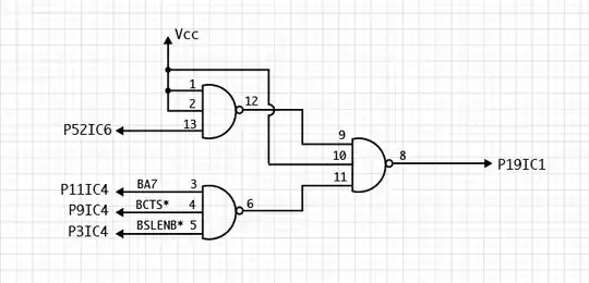

The 26-3124 model can be upgraded according to this image from coco3.com using a 74LS10 and some soldering skills:
Little John's 74LS10 upgrade
Standard CoCo 3 upgrade for the 26-3124 Multi-Pak Interface. The integrated circuit is a 74LS10 Tripple 3-Input NAND. The trace connecting pin 19 of IC1 to pin 52 of IC6 is severed. This circuit is assembled and connected as indicated in the schematic. This circuit restricts the address range of the M.P.I. data buffer to $FF40-$FF7F. The data buffer is aso enabled on SLENB* and CTS*. BA7 is buffered address line A7.
Once you make this upgrade, your MPI will only be address compatible with the CoCo 3.
