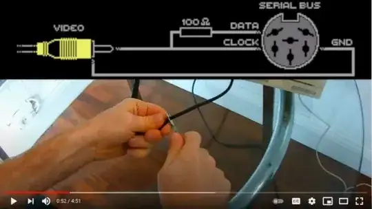

And now this: disk drive outputs the video signal through the serial bus connector! serial-to-video connection
"Freespin" Demo by Matthias Kramm (Quiss/Reflex):
https://www.youtube.com/watch?v=zprSxCMlECA
Technical details are described on the author's website: http://www.quiss.org/freespin/
Every single raster line, we have generate sync pulse by pulling both DATA and CLK to ground for 5 - 8 μs. And of course, we have to switch back and fro between black and white. Since the 6502 runs at 1Mhz, a single CPU cycle is already 8 horizontal pixels. But writing 1800 takes 4 cycles, so every switch between white and black is always at least 32 pixels wide. This is perhaps the biggest restriction of 1541tros, and dictated most of the effects. (Oldschool effects, like rasterbars, chessboards etc. tend to work nicely)
