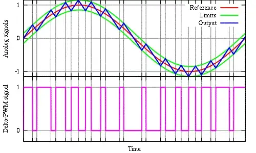

The best audio quality was obtained with pulse width modulation using the square wave voice. The oscillator was set to 0 and the pulse width was set by flipping the pulse width from 0 to maximum.
With the CPU speed at 1mHz the fastest pulse switch rate achievable is around 15kHz, producing a sound wave of 7.5 kHz or less. Setting the low pass filter help smooth the sound.
Pulse width modulation to sound wave example
Source: https://en.wikipedia.org/wiki/Pulse-width_modulation

    Pulse-width modulation needs a carrier greater than 4KHz to get good results; even with a perfect reconstruction filter, an A440 (not a particularly high note) would need to have all harmonics beyond the fourth filtered out; an A880 would only get to have the fundamental and octave harmonic. Most sounds need at least the fifth harmonic before they even start to get "interesting", so a 4KHz PWM rate isn't going to cut it except when trying to produce very low notes. – supercat Dec 09 '16 at 19:48
  • I re-read the digi article in the original answer, and it explains a different way of doing PWM. Will rewrite. – Stavr00 Dec 09 '16 at 20:06
