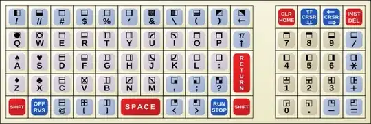

Background: The Original PET Keyboard and PETSCII
Most of these keys have their roots in the original Commodore
PET 2001 keyboard:
The scanning and conversion was complex and seems to have
varied somewhat by ROM version, but eventually a PETSCII code would
be produced from a keypress. For the original keyboard, typing a key
with a printable character would produce that PETSCII character, and
holding shift would produce the same character code but with the high
bit set (128 added to it) to give the graphic symbol printed on the
shifted portion of the key.
The other keys produced PETSCII control characters very similiar to
ASCII control characters. As you can see from the table at line
551 of petdoc.txt, these were:
Lower Shifted Code
RETURN ^M (CR or carriage return)
RVS RVS OFF ^R
STOP RUN ^C (CAN, cancel)
HOME CLR ^S
CRSR ↓ CRSR ↑ ^Q
CRSR → CRSR ← ^]
DEL INST ^T
Using shift with the above keys (excepting RETURN) would
also set the high bit, just as with the other keys, giving a PETSCII
code in the "high control" area.
