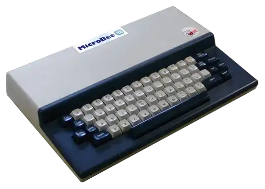

    One popular Australian computer brand in the 1980s was the Microbee. I don't know enough to answer your question but there's something you could read up on if you want. – Omar and Lorraine May 31 '17 at 14:56

As far as the School market in Australia, the locally made Microbee was dominant in the 80's together with the Apple 2e and BBC. The Microbee was mainly sold in Australia (zero to USA) but also sold into Sweden and its neighbours, New Zealand and a few to Israel & Russia. As a result, the USA, UK, etc know very little to nothing about the Microbee.
Microbee also sold well On the home domestic market but never dominant there. The various Commodore's/Amiga's ruled because of their price. The Apple & BBC were to expensive. Then came all the rest of the Spectrums, Ataris, Amstrads, etc. The Exidy Sorcerer and System 80 (TRS-80 clone from Dick Smith Electronics) were also well supported in the domestic market.

    looks like MicroBee is planning a comeback: http://www.microbeetechnology.com.au/classic-plus-kit-computer.htm – scruss Jun 02 '17 at 15:13
    The Microbee has already "come back" when Microbeetechnology launched the Microbee Premium Plus+ in 2012 as a kit. These units are fully compatible with the originally released Premium units of 1985 but using modern components and able to boot from an SD card, boot uCLinux, ethernet port, etc. The soon to be released Classic Plus I believe will also be fully compatible with the 1980's units, cant wait for it to be available :) – Alan Laughton Jun 03 '17 at 01:04

  • The MicroBee was in all the magazines here and I remember it being very slick. I also remember it being very expensive, at least in comparison to what it could do. Apparently they were popular with schools but I guess only the richer schools. My schools had a TRS-80 Model III and a number Apple IIe's and Europluses I think.

The only seriously special thing here was the MicroBee. They look very nice and their specs look very nice. And they're unique to Australia. You don't see them for sale though. Looking on our equivalent to Craigslist I only see a wanted ad (-:
MicroBee
