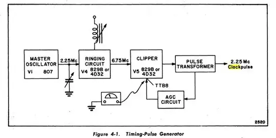

Did the UNIVAC I really have a 2.25 MHz clock speed?
Yes. According to the Univac I Maintenance Manual, the master oscillator ran at 2.25 megacycles per second. See Figure 4-1, page 4-6, reproduced here.
The other answers of course address why the Univac wasn't as fast a computer as it might seem from the pure numbers.

  • Also interesting the very next (4-2) figure showing the generation of the 11.25 "Mega cycles"memory carrier from that source. Trying really hard we could call it a penta-clocked CPU :)) (I always loved how US engineers are afraid of accepting new and especially non.US names- rather accepting inkonsistent symbols instead) – Raffzahn Mar 25 '24 at 23:55
