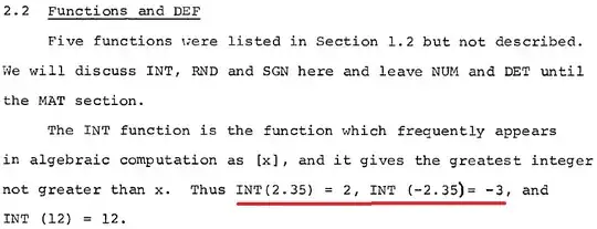

Looking into the 1968 V4 documentation shows the same behaviour
(Page 42 of the BASIC Version 4 manual)

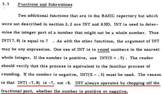

Going back to V2 of 1964 shows different:
(Page 39 of the BASIC Version 2 manual)
This quite complex explanation already shows why Truncate isn't as great for a beginners' language as Floor.
