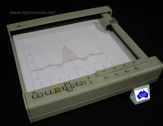

In turn the plotter seems to be a HP 9872, introduced in 1977:
(HP 9872 Picture taken from HPmuseum.net)

    That sin(x)/x graph still looks good. – hobbs Jul 16 '23 at 23:47
  • Did the plotter do those characters itself or was that the driving software? The latter would be usual but HP gear frequently has surprising ahead-of-their-time features. – davidbak Jul 17 '23 at 00:57
    @davidbak Character generation was self contained. The 9872 hat several fonts with 95 characters each (7 bit). Being vector fonts character strings could be printed in arbitrary size by setting the character cell width and height and of course plotted in any direction intended and 'beautified' with a variable slant. IIRC one could also add (a few) user defined characters, so logos or mathematical symbols could be transferred only once. The whole language was made optimized for short encoding. – Raffzahn Jul 17 '23 at 01:13

The pen plotter appears to be an HP 7221 or 9872. They look identical but differ in their interfacing: the 7221 is the RS-232 version and does not speak HP-GL; the 9872 uses HP-IB and HP-GL. If the computer is an advanced HP calculator, the plotter is probably the 9872.
This predates my use of pen plotters, which was in 1984-88, but it uses the same distinctive disposable pens as the HP devices I used. The HP Computer Museum page on pen plotters lists quite a few models: I identified this one by the number and colours of the buttons on its control panel.
