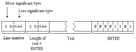

Each line of BASIC is stored in memory as two bytes for the line number, then two bytes indicating the length of the line in bytes, followed by the tokenised text of the line. MERGE protection works by poking the length bytes with bogus values that are larger than any valid program.
These bytes are ignored when running the program (at least, for simple programs that don't need to jump around between lines, which is usually the case for BASIC loaders of machine-code programs) but come into play when editing the program, or inserting lines - as MERGE does when used for its intended purpose. If the reported line length is larger than the available memory, this will fail with an out of memory error or a hard crash.
