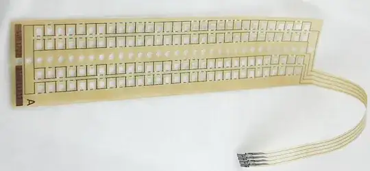

IBM used punched mylar circuits as ROMs.
0's and 1's were encoded by cutting some traces, circuits were probed through small inductors.
http://www.righto.com/2019/11/tros-how-ibm-mainframes-stored.html
Mylar foil Assembly

    True, but they are related to core memory, not PCB nor diode based ROM. – Raffzahn Jun 06 '23 at 20:01
    @Raffzahn the question doesn't ask specifically about diode-based ROM, and these are PCBs. – user253751 Jun 09 '23 at 12:45
  • @user253751 calling them PCB is quite a stretch. Also, they are not building a ROM on their own but part of a stack with many additional components. Using only a single as the OP implies would be not a great idea. – Raffzahn Jun 09 '23 at 21:13
    @Raffzahn True, they're not much of a "board", but that's just because, with no components on it, there's no advantage to it being rigid. You could make it a board and use traces for the inductor grid, but there wouldn't be much of an advantage to doing that since you lose the easy ability to swap the cheap sheets and save very little on construction costs. – Perkins Jun 09 '23 at 23:21
  • @Raffzahn Another term for a PCB is "printed wiring board" - which criteria don't these meet? – user253751 Jun 10 '23 at 06:44
