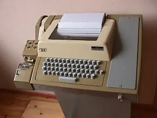

I have read that the early terminals were Teletypes, for example:
Teletype
So you send your input to the (large) computer, and then you receive the result which gets printed on paper I suppose.
But could you actually see what you were typing? Does a Teletype have a small screen or something that allows you to see what you are typing?

You could see what you were typing because it appeared on the paper in front of you. A teletype is just an electric typewriter at heart.
There was no screen, the picture is just as the system was.
The teletype was the console input to the computer. Once logged in, you had the standard command prompt. You entered your command which was sent to the mainframe character by character as you typed it. Then the response was presented on the paper. This was replaced by the console, or shell, display on a video monitor when such things came along later.
As shown in your picture, there was a punched tape reader / writer on the left hand side, so you could also "type" onto punched tape, or read the contents of tape into the computer or onto the roll of paper.
I spent my formative years programming on these. They were very slow to use because the keys had to be depressed a long way before contact was made and the keystroke detected. This made it impossible to touch-type at any sort of respectable speed. They were also incredibly noisy. The sound of the clattering carriages in a room full of a couple of dozen of these could be deafening.

    "They were very slow to use" - this is the main reason behind the oldest UNIX programs being so cryptically named - ls, rm, cp, etc. Only having to type two characters rather than four on one of these things is a significant saving! – Muzer Apr 19 '17 at 09:06
    @Muzer: Indeed so, and also why on games like Adventure, you entered single character commands. – Chenmunka Apr 19 '17 at 09:23
  • "You entered your command which was sent to the mainframe character by character as you typed it" What if you pressed a wrong key, does a Teletype have a backspace key? – user7681202 Apr 19 '17 at 09:57
    @user7681202: Yes, it had a BS and a DEL key. – Chenmunka Apr 19 '17 at 10:01
    However, it's probably important to remember that since the output was printed, backspace simply moved the location of the printhead and didn't (and couldn't) actually erase the character. – Edward Apr 19 '17 at 11:43
    That's also why you have back space and delete instead of just a single key that erases the last character typed. Back space moved the type head back one and also the paper tape. Delete sends a delete character to the computer (if connected) and punches a line of holes in the paper tape which would obliterate any existing character there. This is why ASCII DEL is 0x7f – JeremyP Apr 19 '17 at 12:03
    The model looks like a golf-ball, so the head "jumps up" to print each character, leaving what you've typed fairly clear. Some later teletypes used a daisy-wheel or a dot-matrix head, which often would obscure the last couple of characters typed. Many would move the head to the right by an inch or so a few seconds after the last character typed so you could see what had just been typed (and then moved it back when a key was pressed). – TripeHound Apr 19 '17 at 12:14
    @JeremyP: If a character was inadvertently punched on the tape of the ASR33, it was necessary to first push a button located on the punch itself to back the tape by one position, and then type a rub-out character which would punch all the holes. Rub-out was just an ordinary character which would cause some receivers to do nothing and others to show a "deleted character" marking, but basically the idea would be that if one typed "hellp", backed up the type, hit rubout and then typed "o", the tape would end up with "hell▒o", which should hopefully be recognizable as "hello". – supercat Apr 19 '17 at 15:41

    Note that it is NOT true that the characters were immediately printed. The keyboard operated independently from the printer, and you could, in theory, be typing one thing and printing another. When the printer was not connected you just got a sort of brief buzz from the machine when you depressed a key. (Usually this meant that there was a wiring error or that the attached computer was not echoing your keystrokes for some reason.) On machines where there was a software-provided "echo" the printing came a disturbing length of time after the key press. – Hot Licks Apr 20 '17 at 19:35
23
Many Typetype-style devices (I'm not positive about the popular Teletype® brand ASR-33 itself) could be switched to use "full-duplex", "local", or "half-duplex" mode. In full-duplex mode, characters which were typed would be transmitted to a remote machine but would not be processed locally. In local mode, they would be processed locally but not transmitted. In "half-duplex" mode (so named because it was suitable for use on "half-duplex" lines that could either transmit or receive, but could not do both simultaneously), characters that were typed would be both transmitted and processed locally.
In cases where such usage would be practical, the optimal behavior is often to have characters that are typed be transmitted without being processed locally, but then have the remote system echo back characters as they are processed. This can provide the user with clean feedback as to when and how characters are being processed, but requires that characters be processed as soon as possible with minimal buffering delays. Single-user computers seem to favor such an approach since a computer that is doing nothing but awaiting input will be able to respond to it quickly. Today, Unix systems seem to use a hybrid approach where the terminal itself is not expected to echo characters locally, but the characters get echoed by the system automatically before the application layer requests them.

    The knob on the front is for selecting "Line" (to the left), "Local" (to the right), and "Off" (straight up). Local was used for punching the tape, which you could then feed back to the reader in Line mode so that your "connection time" was reduced. Many remote locations paid for CPU time and Line time (kind of like minutes on the cell phone now), and if your access was over a toll line, spending time typing in a program, line by line, got very expensive. Duplex settings were part of the communications unit. In Line mode nothing was printed until it was received, or "echoed". –  Apr 20 '17 at 02:58

I own a DEC pdp8/e and two ASR-33 Teletypes.
The ASR-33 can operate in "Line" or "Local" mode. In Local mode, characters are printed as they are typed. This mode is used for reading and punching paper tapes.
In Line mode, typed characters are sent down the line to whatever host you're communicating with. Typing makes a "Bzzt" noise for each character as the mechanical parallel->serial converter spins but nothing is printed. It is the responsibility of the Host to echo back the characters being typed.

You could see what you were typing, as others have said, because the print head (which was cylindrical) rose up and rotated until the right character was in place, then slammed forward to smack the (simultaneously raised) tape and make a mark on the paper, and then dropped back down. The raise-spin-slam-unspin-and-lower sequence was rather noisy -- and not just the "slam" part.
On a distantly-related note, the data-transmission mechanism for directly-connected model 33s was the "20 mA current loop" -- a loop of wire that went from A to B and back. Machine A would send pulses into this loop by raising the voltage on one end until a current of 20mA flowed, hold it there for a short time, and then release. That was a "1" bit, I believe. A similar stretch of time with no current was a "0" bit.
The cool thing about the 20mA design was that it really didn't matter how long the wire was, or how resistive (up to a point!): if 20mA is flowing HERE, then 20mA must be flowing THERE, and be enough to activate a solenoid or whatever at the remote location. For long wires and higher speeds, things look less and less like switched-DC, and more and more like high-frequency analog signals, and things like inductance and capacitance make the whole plan less workable. But it sure was a cute first draft!

Yes, you could... The usual way of sending messages was to punch a paper tape first, and then run it through the tape reader, but you could also type directly, and even communicate as a 'chat', in real time and with the two texts clearly differentiated by the usual two-color tape, red and black...
