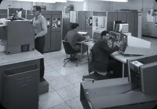

Of course, the commands the user types will appear on their own console (de facto because a teletype is just an ink-on-paper typewriter), but importantly the output of these cat commands will go to standard out, which may be a different teletype than the one on which the commands are entered.
For example, in this picture the console teletype giving the commands (middle of photo) is routing output to the large line printer (left of photo):
> Cecelia Larsen [is] sitting at the console typewriter and Bob Kuhn [is] sitting at the CRT. I do not recall the name of the person standing at the Analex line printer.
In this picture, we see the Self Service I/O Area at Columbia University, circa early 1980. Notice that this multi-user environment was also multi-room, with input terminals a good distance away from output terminals.
The Columbia University Self Service Input/Output Area, circa early 1980s.
