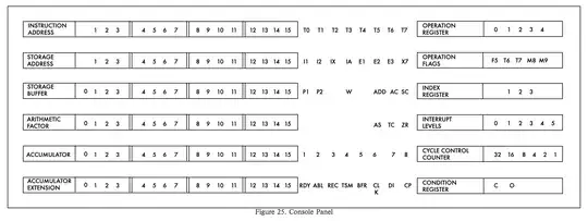

  • DEC PDP-8. As you can see in the block diagram on page 2 of the User's Handbook, there is a memory address register (MAR), a memory buffer register (MBR), a program counter (PC), an instruction register, and an accumulator.
    There is no dedicated status register, but the "link" register which here is considered close to the accumulator would be part of the status register.

The old IBM1130 comes close. Here's the console, which displays much of the CPU state:
INSTRUCTION ADDRESS is your PC.
INTERRUPT LEVELS + CONDITION REGISTER are your SR.
OPERATION REGISTER + OPERATION FLAGS + INDEX REGISTER are your CIR.
STORAGE ADDRESS, STORAGE BUFFER, and ACCUMULATOR should be obvious.
It has an extra ARITHMETIC FACTOR separate from the STORAGE BUFFER. I believe this is because core memory must be rewritten after each read, while multiply and divide involve multiple additions and subtractions with modified operands, so keeping these separate is handy.
The ACCUMULATOR EXTENSION supports multiple precision arithmetic, an added feature beyond your model.

  • It has a WAIT instruction, too. I'm not quite sure how ARITHMETIC FACTOR relates to STORAGE BUFFER (I thought I got it, then I looked at the diagram at the end of CPU Functional Characteristics) and I'm not sure whether the execution model matches, but this is a great find, thanks! – wizzwizz4 Jul 04 '22 at 18:13
    @wizzwizz4 Find? I used to program these ツ – John Doty Jul 04 '22 at 18:17
  • Ooh. How closely does the execution model match fetch, decode, execute, handle interrupts? – wizzwizz4 Jul 04 '22 at 18:19
  • @wizzwizz4 That's how we thought about it as programmers. In hardware, there was a lot of finer-grained stuff going on. For example, parallel adder with serial carry, so it could take 15 clock cycles to compute a 16 bit sum, although it was usually fewer. – John Doty Jul 04 '22 at 18:25
  • Is there a decode phase / circuitry? Is more than one instruction "executing" at once, ever? Do interrupts ever interrupt an instruction, or do they only occur in between instructions? Are there general-purpose registers, other than just core memory? – wizzwizz4 Jul 04 '22 at 18:29
  • @wizzwizz4 There was a decode phase. I forget which clock step it happened at. Only one instruction at a time. Interrupts happened between instructions. To the programmer, there were three "index registers", but they were actually core memory locations. – John Doty Jul 04 '22 at 18:40
    The index registers have special treatment in the instruction representation… I'm inclined to say that this is a perfect (or near-perfect) match! – wizzwizz4 Jul 04 '22 at 18:43
