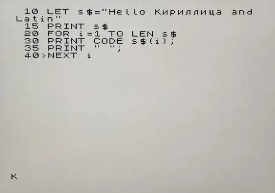

As example here's the BASIC program printing mixed languages text: enter image description here
And this is its output: enter image description here
