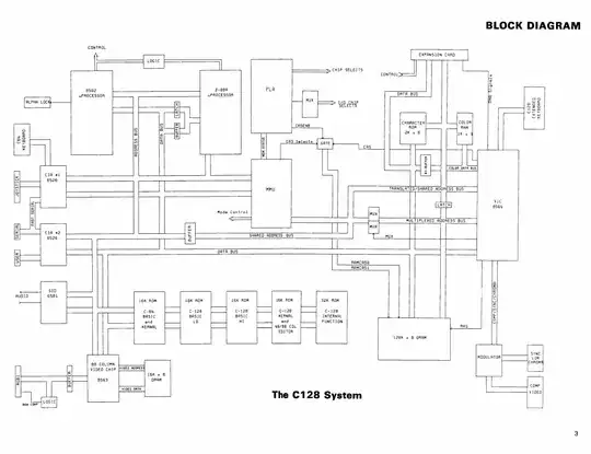

Here is the System Diagram, taken from page 3 of the C128 Service Manual (C128SM - click to expand): C128 System Diagram Remember the big deal I made of the 80-column 8563 Video Display Controller in my first answer? That's the tiny bit in the lower left corner. It is almost completely isolated from the rest of the machine, except for the address and data buses. That is why communication with the 80-column video RAM takes place via two registers of the 8563. The 8563 has 37 registers total, allowing control of number of characters per line, number of lines, cursor position, video synch, etc.
You might be thinking, "There is a lot going on in that diagram." Yes. The C128 is essentially 4 computers in one box:

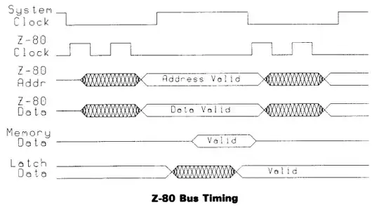

  4. a Z80A computer for running the CP/M operating system. It runs at 4 MHz, "half the time".
"Huh?" A diagram is in order, from page 8 of the C128SM: Z-80 Bus Timing Diagram
"Okay, I sort of get it. The Z80 clock is only running half the time. I see it, but that does not explain why?." The system clock is a 1 MHz clock provided by the VIC chip. In modes #1 and #2 it lets the 8502 run half the time, and allows itself half the time to update 40 column video RAM, move sprites, etc. One nice thing about 6502-family chips is that turning over half their time to something else costs them nothing, so they share with other stuff on the bus easily. In mode #3 it runs at 2 MHz and drives the 8502 at 2 MHz. Since the 40-column display is not active, the VIC need not worry about sprites and ignores the 40-column video RAM. Note, though, that this 2 MHz mode would not help the Z80A; at best it would simply force that chip into a semi-even 2 MHz mode.

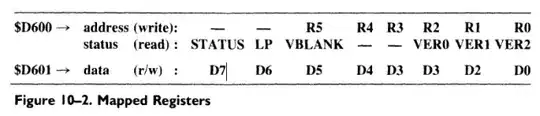

All 80-column screen communication occurs through the two 8563 registers, mapped to memory locations $D600 and $D601. Figure 10-2 illustrates this, from page 295 of the C128 Programmer's Reference Guide. 8563 Mapped Registers $D600 tells which of the thirty-seven 8563 registers you wish to read or write, and $D601 is the location to read or write the data. Since the 8563 is often occupied with its own memory and driving the 80-column screen, it can take time to handle the $D601 value. That's why you must always check the $D600 STATUS bit before reading from or writing to $D601. One useful feature of writing to register 31 (data register) is that the screen location auto-increments after the write. You need not manually increment it.

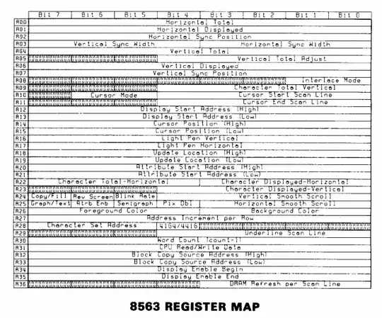

... not a poor design at all. I'll end with showing the 8563 register map to give you an idea of all the things this chip is handling. This is from page 37 of the C128SM. 8563 on-chip registers

Others have pointed out the slowness causes, but here I will point out some solutions. Firstly, switch to ZPM which is a Z80 BDOS replacement for the 8080 based CP/M BDOS. CPMFAST is another option to speed up the general OS.
From a programmers' perspective you can bypass BDOS and BIOS and drive the VDC directly as I've done in SG C Tools (also turn off 40 column display). Although this will not help existing programs such as Wordstar it does dramatically speed up programs specifically written for the C128. The C code looks like the following to draw a string at x,y:
uchar invdc(uchar RegNum)
  outp(vdcStatusReg,RegNum);                  /* internal vdc register to read */
  while ((inp(vdcStatusReg) & 0x80) == 0x00); /* wait for status bit to be set */
  return(inp(vdcDataReg));                    /* read register */
void outvdc(uchar RegNum, uchar RegVal)
  outp(vdcStatusReg,RegNum);                  /* internal vdc register to write */
  outp(vdcDataReg,RegVal);                    /* write register */
/* fast vdc string print given x and y offset in current page */
void printstrvdc(uchar X, uchar Y, uchar Attr, char *TextStr)
  register uchar I, TextLen;
  ushort DispOfs;
  TextLen = strlen(TextStr);
  if(TextLen > 0)
  DispOfs = Y*vdcScrHorz+vdcDispMem+X; /* calc disp mem offset */
  fillattrvdc(X,Y,TextLen,Attr);       /* use block fill for attrs */
  outvdc(vdcUpdAddrHi,(uchar) (DispOfs >> 8));
  outvdc(vdcUpdAddrLo,(uchar) DispOfs); /* set addr of first char */
  for(I = 0; TextStr[I]; I++)          /* send str to vdc disp mem */
    outvdc(vdcCPUData,TextStr[I]);

I am far from C128 expert of any level (HW or SW), but I think one (expensive) change could solve all those speed issues. Certainly it is not possible afterwards, but could be a design route to speed up the machine, and would keep C64 compatibility at the same time, whil Z80 could run in full 4 Mhz mode (though it does not solve the several layers and BIOS routing / slow screen update). As it was not mentioned beforehand, I write down the idea.
Reading through the descriptions and time diagrams, VIC-II need to be in 1MHz mode to update the DRAMs. And because of the 1MHz of VIC-II, the Z80 and the 8502 need to be is slow mode too. But what if there would be no DRAM in the machine, just SRAM, requires no frequent refreshes, and does not degrade content (the same as the color RAM on C64)? In that case the VIC-II 1MHz mode could be cancelled in C128 and Z80 mode, or it could run continuously in 2MHz mode. Certainly SRAMs were (and still) more expensive than DRAMs, but the speed is there. As my current C=16 64K memory expansion is based on SRAMs, I though I let you know this idea.
MMS
  • Welcome to RetroComputing, and thank you for sharing the idea, I'm guessing that implementing your idea would have been costly , and likely not as easy as it sounds. – RichF May 04 '20 at 02:25
  • Actually, the VIC-IIe refreshes the DRAMs even in 2MHz mode when the 8502 is running. So I don't think this is the reason why FAST mode and Z80 operation are (in practice) incompatible with each other. – TeaRex May 04 '20 at 09:13
As far as I know the Z80 only runs at the same 2MHz the 8502 runs at. Which, internally, works out to 2/4=0.5MHz. Which is just plain slow. Source: a guy who came to visit our desk last night and knew everything else about the machine. So take with a grain of salt and downvote as much as you like.
Sixtyfive
  • 131
    Thanks for sharing this, but I don't see why you'd divide 2MHz by 4. Where did the 4 come from? – wizzwizz4 Dec 28 '18 at 17:59
  • Good question. Like I said, a guy came by and said so. I googled for "z80 clock divider" now and found at least one thing (http://www.cpcwiki.eu/forum/programming/z80-clock/) where someone (2nd post) talks about a "divide by 4 circuit". Perhaps someone else can shed some light ... ? – Sixtyfive Dec 28 '18 at 18:14
    In case it helps to dispel a myth: the shortest instruction on a Z80 takes four cycles, comprising two memory accesses (a fetch and a refresh) of two cycles each. Most other memory accesses take three cycles so the next big tranche of Z80 instructions is those that are seven cycles long, but there are fives and sixes, and various others that obviate any sort of attempt to fit everything to a pattern of 4n, or even 4 + 3n. – Tommy Dec 28 '18 at 18:14
    @RainerVerteidiger the Amstrad is special because it does some trickery with timing signals to coerce a 6502-esque fixed memory access cadence, with memory available for video every other tick. Which does end up (approximately) rounding up every instruction to a multiple of four cycles. But other machines use various different schemes — on the Spectrum there's no rounding or other penalty while the processor is accessing RAM that video can't be in, on the MSX there's an extra cycle in every instruction fetch but everything else runs at the natural speed, etc. – Tommy Dec 28 '18 at 18:21
  • Rainer, you are both right and wrong. The z80 runs at an "effective speed of 2.04 MHz". Right. However, it is clocked at 4.08 MHz, but only half the time. That's the sort-of-wrong part. A number of early cp/m machines ran at 2 MHz, so that in itself was not unusually slow. Later 4 MHz become the common speed, though. Note that in competition with the 6502, a 2 MHz z80 was roughly equivalent to a 1 MHz 6502. (generally 4 cycles to do very basic stuff on a z80 vs 2 cycles on a 6502) – RichF Dec 30 '18 at 18:18
