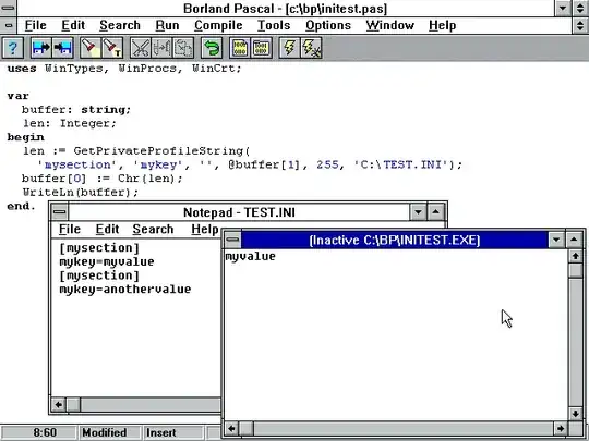

You have been wrong for 30 years.
I wrote the test program below and compiled it with Borland Pascal 7:
uses WinTypes, WinProcs, WinCrt;
var buffer: string; len: Integer; begin len := GetPrivateProfileString( 'mysection', 'mykey', '', @buffer[1], 255, 'C:\TEST.INI'); buffer[0] := Chr(len); WriteLn(buffer); end.
Then I ran it with the INI file from the question saved to C:\TEST.INI. It output myvalue both in Windows 3.10:
Test program run in Windows 3.10

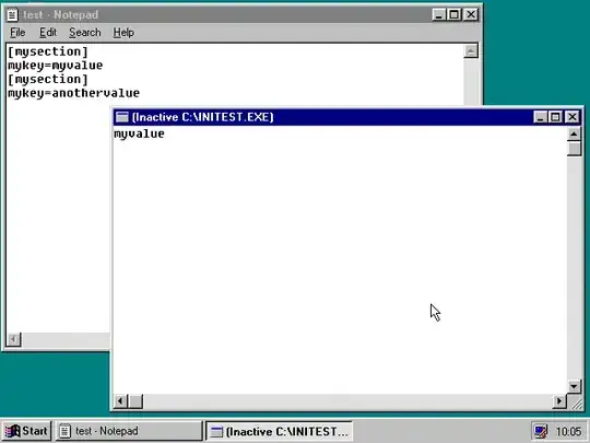

and in Windows 95:
Test program run in Windows 95
Whatever INI-modifying utilities you were speaking of were simply not doing their job right. Sorry, old software was made of duct tape, smoke and mirrors, just like today. Where did you think we inherited this from?
